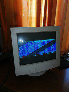

Hello guys, found a 15"crt today but i'm having a bit of a problem. The screen is small verically and won't strech even at 100%. I tried every dial ion the back, only found a verical size but not a horizontal dial.
The monitor is L503BLD multiscan. Any idea what to check next?
Any input will be greatly appreciated!
Thank you.

Found the resistors, adjusted for h/v size but the verical is only a bit larger. Nowhere near the full screen. The brightness and clarity of the monitor is top notch! I dont think that it is the flyback. Can a capacitor cause this?

It is unlikely to be a capacitor issue, there's no raster distortion or anything (or is there ? any jitters or other instability), just that it is not tall enough. I can suspect some cold solder in the frame amp section, perhaps a component in the feedback section isn't connecting well and ends up causing it.
Getting access to the entire board for visual checkup can be a challenge, a number of clear and focused photos can be most helpful.

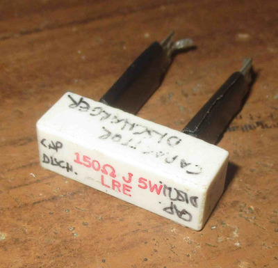

The big capacitor on primary side is the one that will be able to kill and one should discharge it before handling the board. Deflection supply one on secondary can bite pretty hard but that one usually discharges pretty quickly on its own, cathode amp supply likewise, but it is always a good idea to use a resistor to discharge anything with 50V or more written on it. I use this :
The attachment IMG_5298.jpg is no longer available
Dielectric absorption is definitely at play on a kinescope itself. When you disconnect the anode cup, you always want to keep it connected to aquadag to prevent the charge from building up. Also it'll pick up all the static electricity from just any handling, the kinescope itself is a pretty good leyden jar (read : capacitor) and when you go back to connecting the anode, it will be able to surprise you in the most unwanted way 🤣
