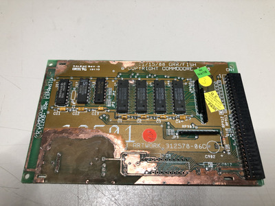

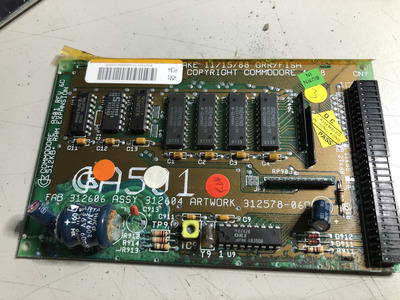

It would me remiss of me to not mention this --- the 512k 'trapdoor' memory module (under cover on bottom of A500 case) often came with a RTC and the dreaded Varta backup battery. These cards are often encased in a soldered tin RF shield, and the fact the varta is leaking all over the board goes un-noticed. I would obtrude upon you to check your expansion memory module ... here's an example of the carnage..
...corroded thru to PCB substrate in many places, entire RTC section needed replacing, fortunately the ramfield survived ...
