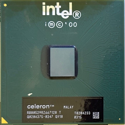

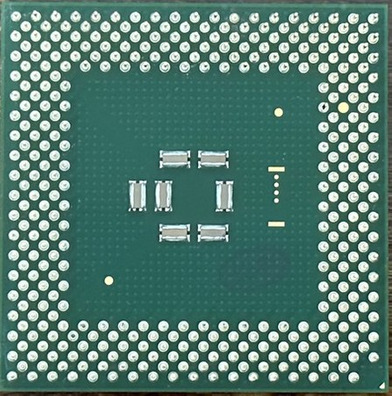

First we start with an Intel Timna engineering sample CPU: Q-Spec QV18, rated for 667 MHz and manufactured in May of 2000. It looks a lot like a standard Socket 370 Celeron, but the pin-out is slightly different.
86.01 KiB
2252 views
Intel Timna CPU
GPL-2.0-or-later
72.31 KiB
2252 views
Intel Timna CPU back (QQ30ES)
GPL-2.0-or-later

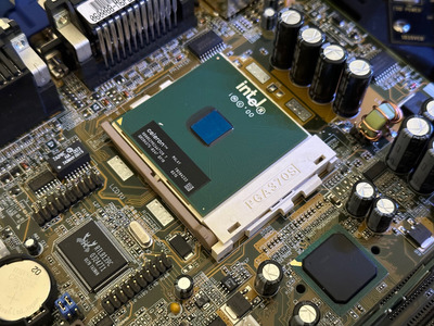

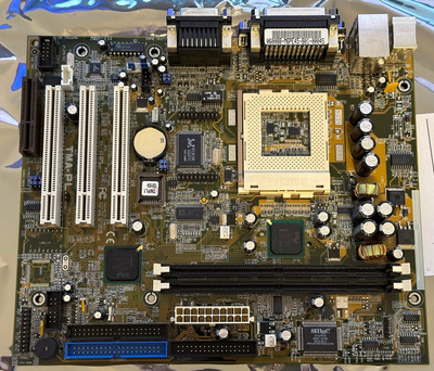

Next we need a motherboard. This is an ASUS TMA-PL pre-production Socket 370S motherboard for the Intel Timna. It has no chipset northbridge, since that functionality is integrated with the CPU. So all it has is the MTH for memory translation and an ICH2 southbridge.
862.68 KiB
2252 views
ASUS TMA-PL Motherboard
GPL-2.0-or-later
697.22 KiB
2252 views

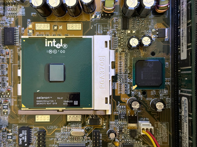

CPU installed
GPL-2.0-or-later

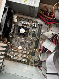

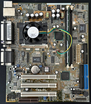

Since this is a low-cost Celeron build, I'm sticking with the integrated Timna graphics and the on-board AC'97 audio. No need to fill up any PCI slots here. Just add a 128 MB stick of CL2 PC133 SDRAM, add a heatsink/fan, and it's good to go.
684.07 KiB
2252 views
ASUS TMA-PL with CPU and RAM installed

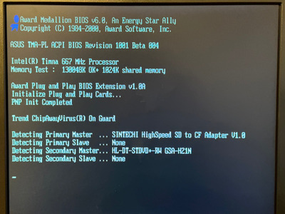

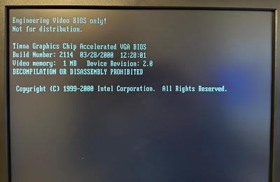

Boot up and Windows 98 SE installation:
287.37 KiB
2224 views
BIOS POST
GPL-2.0-or-later
345.52 KiB
2224 views
BIOS POST
GPL-2.0-or-later

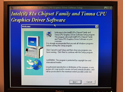

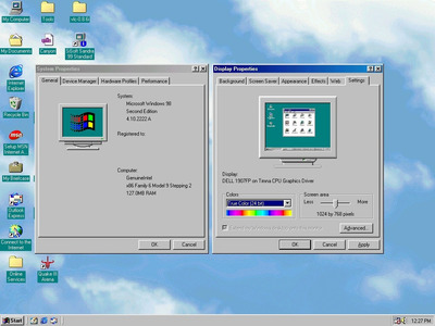

Installing Windows 98 had one major hurdle: graphics drivers for the Timna integrated graphics. I was able to easily find ICH2 drivers for the other chipset functions, and integrated audio drivers for another board, but the Timna graphics drivers were a challenge. Thankfully I was able to track down a single old FTP site with some BETA ASUS drivers that had the pre-release Timna graphics driver installer for Windows 98. (I also found one for NT 4.0 and 2000).
799.59 KiB
2224 views
GPL-2.0-or-later
Windows 98 SE installed with all drivers working! The CPU is recognized as Family 6 Model 9. This model number was re-used for Pentium M Banias after Timna was cancelled. Interestingly, the team that developed Banias also worked on Timna.

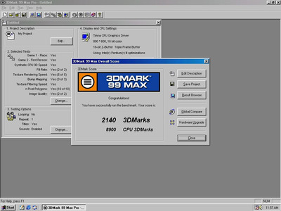

Benchmarks:
3DMark99
2140 3DMarks
8900 CPU 3DMarks
102.47 KiB
2221 views
GPL-2.0-or-later
149.86 KiB
2221 views
GPL-2.0-or-later

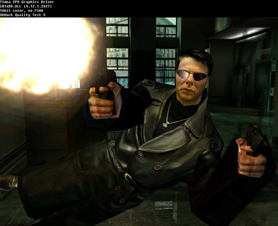

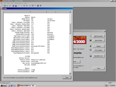

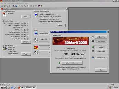

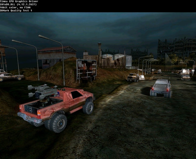

3DMark2000
888 3DMarks
122.1 KiB
2221 views
GPL-2.0-or-later
131.77 KiB
2221 views
GPL-2.0-or-later
223.78 KiB
2221 views
GPL-2.0-or-later

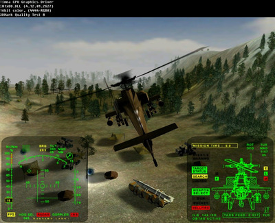

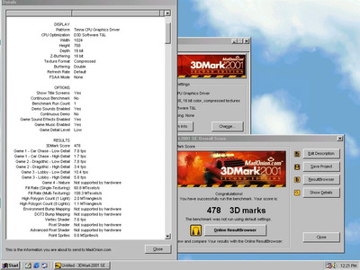

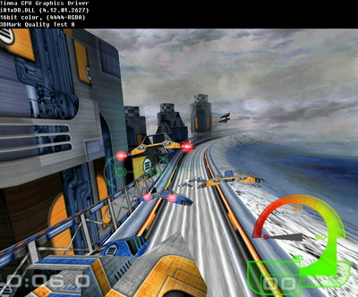

3DMark2001SE
478 3DMarks

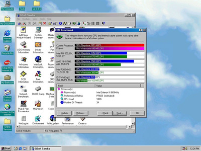

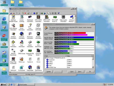

SisSoft Sandra 99
193.25 KiB
2213 views
GPL-2.0-or-later
204.75 KiB
2213 views
GPL-2.0-or-later
Memory performance is pretty terrible as expected due to the Memory Translator Hub (MTH).

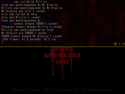

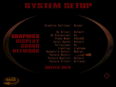

Quake III Arena
Time Demo 1: 32.2 fps at Normal settings
30.46 KiB
2206 views
GPL-2.0-or-later
43.03 KiB
2206 views
GPL-2.0-or-later

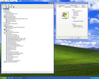

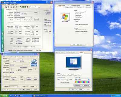

UPDATE: I installed Windows XP and can confirm that it is compatible with the Windows 2000 Timna Graphics drivers
Details:
The driver installer crashes under XP, even with Windows 2000 compatibility set. Trying to do an automatic installation through device manager by specifying the INF also results in a compatibility error. However, if you use the "choose driver myself option" and force it to install the Windows 2000 driver, it works totally fine with XP.
269.1 KiB
1417 views
GPL-2.0-or-later
201.33 KiB
1417 views
GPL-2.0-or-later

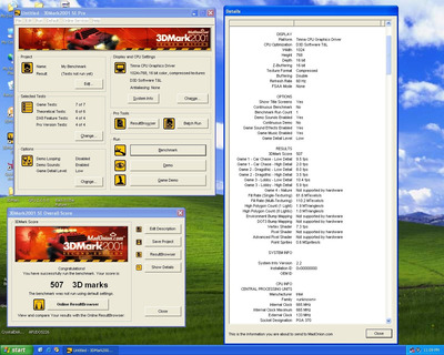

Benchmarks:
3DMark2001SE
507 3DMarks

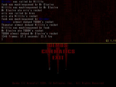

Quake III Arena
Time Demo 1: 23.5 fps at Normal settings
38.33 KiB
1417 views
GPL-2.0-or-later
It's very interesting that 3DMark2001SE scored slightly better in XP than on 98, but Quake III ran ~27% slower.

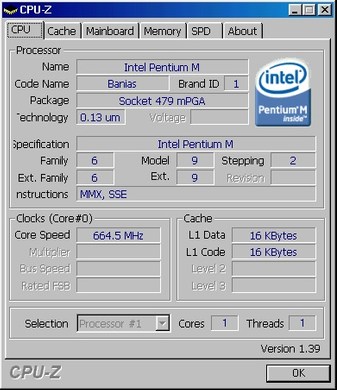

Every version of CPU-Z starting with 1.40 results in a VXD related BSOD. Older versions do work, but don't report correctly or very much info. Here's a screenshot from 1.39. No surprise that it's reported as a Pentium M Banias since that's the CPU which re-used the family and model originally allocated to Timna. Older versions report it as Intel P6.
37.21 KiB
1782 views
CPU-Z 1.39 Timna

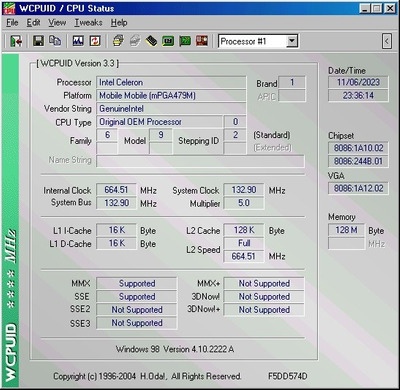

Fortunately, wcpuid works very well and reports lots of useful information:
The CPU clock speed, bus speed, multiplier, and cache info here are all correct. Timna uses a 133 MHz bus rather than the 66 MHz of a standard Celeron, and it has 128 KB of L2 cache. Stepping 2 makes sense since this QV18 is a A2 stepping of the Timna core. I have a 600 MHz QQ30 Timna which should be Stepping A1, but I have not tried to boot it yet. That CPU has a couple of slightly bent pins so I opted for the QV18 first. The socket info is incorrect, but likely related to Banias re-using the Family and Model allocated to Timna.

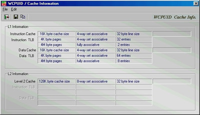

Detailed cache information. I assume this matches a typical Coppermine Celeron, but need to confirm.
56.73 KiB
1782 views
wcpuid CPU cache information

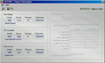

Chipset info
57.58 KiB
1782 views
wcpuid Chipset information
GPL-2.0-or-later

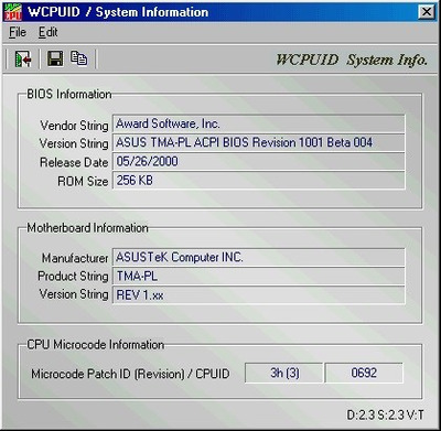

Motherboard/BIOS info
42.75 KiB
1782 views
wcpuid motherboard information
GPL-2.0-or-later
I'll try running the tool after I get this Timna machine working on the internet. For now I posted the wcpuid image to the QV18 page. If I run QQ30ES I'll do the same for it.
