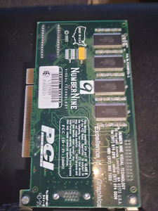

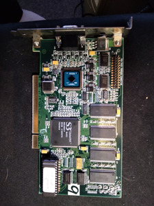

Can someone tell me what card this is and is it good for dos ?

It's a PCI video card with the S3 Vision968 chip: https://www.vgamuseum.info/index.php/cpu/item … 55-s3-vision968
It's rated as having generally good DOS games compatibility.
Performance-wise, it's not as fast as the S3 Trio64 in DOS, but would be faster in Windows. Benchmarks are here: Re: Benchmarks for high-end VLB graphic cards - ET4000W32P/ARK1000VL/Trio64/S3 Vision968/Mach64
Pentium 4 Multi-OS Build
486 DX-33 with 5 sound cards
Reply 2 of 6, by Grzyb
Dual-ported VRAM.
Below average in DOS games, much better in high resolution/color/refresh modes.

NICE IBM RAMDAC
