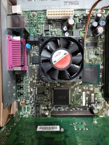

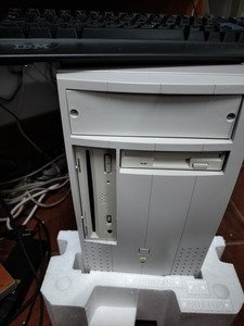

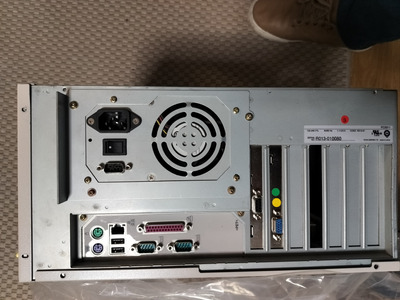

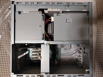

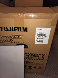

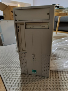

So I bouth 2 units off this very weird machines, brand new and sealed in the box, on Facebook market place, which I could not find any information online.
From the looks it seems it might have been a machine for office use as it contains license for Windows 2000 Pro.

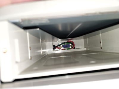

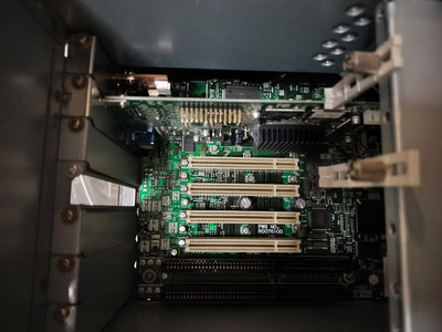

The case and the interior disposition of the hardware is also unusual. It contains some weird port in the back. In front on top there is some big and long drawer with also a weird input.
The only think i recognized was the GPU, a GeForce MX2 32mb. The CD-ROM seems to be and old school Matsushita.
I tried to turn it on, the power supply works but the board does not do any beeps when turning on and no image. But only when I power it off it does small bips. Weird!
Maybe the problem is the clock battery? After all this years for sure is shot.
Can anyone help to clarify what are this machines?

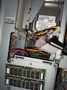

Reply 2 of 15, by soupapes
Tried to revive with adapting a CR2 battery.
Also tried to replace the GPU but still no luck.
The HD is from 2007 so is not that old machines than I expected.

Reply 4 of 15, by PC Hoarder Patrol
soupapes wrote on 2023-11-09, 21:22:
So I bouth 2 units off this very weird machines, brand new and sealed in the box, on Facebook market place, which I could not fi […]

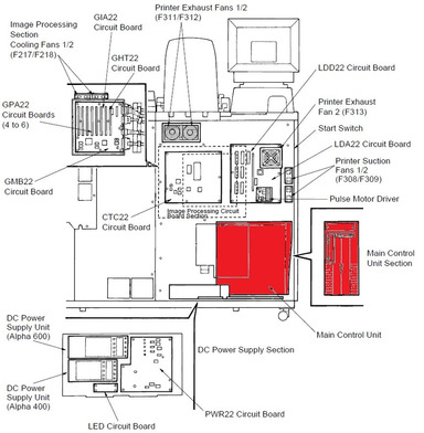

It's the main control unit from a Fujifilm Digital Minilab - probably one of the older models; something like the FRONTIER 330 (or earlier). The 'mystery' front bay is for the optional UPS battery.
Ricoh mainboards featured in a number of their systems (probably with a custom BIOS to support its main use) - from the pics, yours seems to be model FB2L1-13.
Not sure how it'll operate when separate from the rest of the hardware.

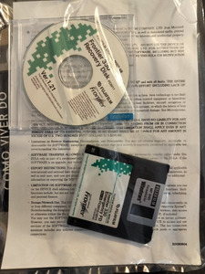

It comes with a CD mentioning Frontier 330.
Also notice that front case only has two power wires directly to the Power Supply, so makes sense to be for battery.

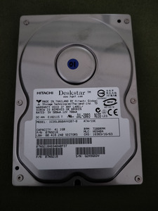

Reply 6 of 15, by soupapes
It also comes with two Hard drivers.

Doesn't seem to be much detailed info on the control unit itself, though you can see it in a bit more context in section 18.4 of the Frontier 330 Service Manual here - https://www.nodevice.com/service-manuals/othe … lm/frontier-330

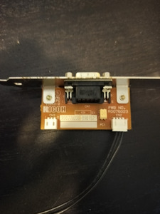

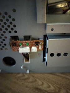

Reply 8 of 15, by soupapes

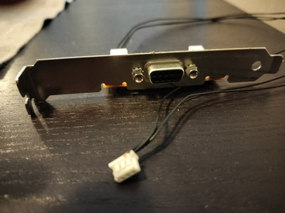

This interface in the back is connected into the small Power Button board on the front. Maybe its expected something to be connected to allow power on the motherboard?
- IBM Aptiva 2176/P166/Matrox Millenium 4Mb/Voodoo1 4Mb/48Mb/8Gb+8Gb SD-IDE/SB16/Win98SE
- 486 DX2 66/CL-GD5424/32mb/HD 600mb/Mozart601/Dos6.22+Win3.11
- P166MMX/S3VirgeDx/96Mb/8Gb SD-IDE/SB16/Win98SE
- P4 3GHz/FX5700/2Gb/HD 80Gb+160Gb/Win XP

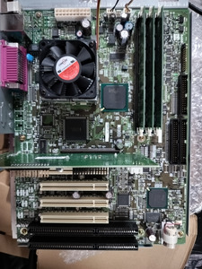

Reply 9 of 15, by DerBaum
the pcb markings (behind the pci slots) suggest you can set a jumper in the frontpanel io pins to power the mainboard by a "switch" or "ac-on".
there are also pins for a power button.
also the db9 connector in the power supply is concerning... but maybe thats there to monitor/control the UPS?

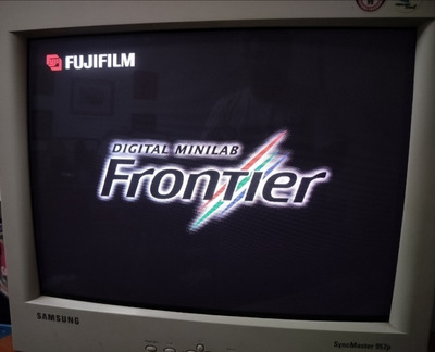

Reply 10 of 15, by soupapes
It seems the unit is faulty.
The second computer works fine.
Comes with diferente CD-Rom modelo and smaller pair of HD with 20gb each.
It has a PhoenixBIOS with a boot screen from Fujifilm.
Comes with Windows 2000 installed, 392Mb RAM, and a Celeron 566.

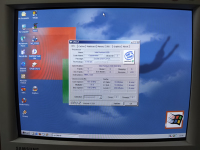

Reply 11 of 15, by soupapes
On the second machine that is working I tried to replace the Celeron CPU with a spare P3 866 but the board only takes 650MHz. I guess it still a good upgrade.
Also upgraded to a Pioneer DVD drive.
But the bios is very disappointing, only detects each HD with a maximum of 20Gb aldo they are 40gb HDs.
Cannot find online any information or BIOS upgrade for this motherboard.

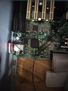

Reply 12 of 15, by soupapes
The board

Reply 13 of 15, by H3nrik V!
soupapes wrote on 2023-11-15, 22:46:
Probably a chipset that only supports up to 100 MHz FSB?
