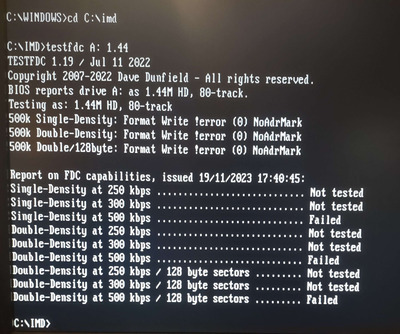

Hello Vogons, I think I have a problem with my floppy controller or port on my ASRock 775i65G R3.0 motherboard.
I have a Sony MPF920 floppy drive that can't read, write, or format in Windows, DOS, or use as a boot device. I've confirmed that the floppy drive and cable do work in another machine (ASRock 4CoreDual-SATA2 R2). Just to be safe, I tried several different cables as well. All the relevant BIOS settings are set properly. Reflashing the BIOS didn't help either.
In Windows 98 and XP the drive shows almost no signs of life. It clicks and spins the disk up but then does nothing before saying the disk isn't formatted. When attempting to format the disk, it seems to do nothing then spits an error message saying it can't be formatted. No head movement at all. I thought it could be an alignment issue but, in another computer, it doesn't have this problem.
In DOS I tried a tool call TESTFDC by Dave Dunfield, which did move the heads, but failed the write test with:
!error (0) NoAdrMark

Tried the same program with the same drive on a different machine, and it passes all but the 128 byte sector tests.
Now an EE question. I was wondering if there was a grounded pin on the motherboard's FD port so I took some measurements. All the voltages seem to be present, and all the ground pins do indeed have a near 0 ohm path to ground. On the known working 4CoreDual motherboard though, all the active pins seem to terminate to ground with a 1.6k ohm resistance. However, on the seemly faulty 775i65G board, all the active pins have no path to ground at all. Should they be terminated? Would sticking a bunch of 1.6k ohm resistors in the drive B connector be wise? Is that even a problem at all?
On strange thing I encountered was, when I was trying different floppy drive options in the BIOS, I set it to 5 1/4" and it could actually read the directory of the floppy disk. But not read or write to it otherwise.
Hope someone can help. I've done a lot of Google searching and have come up with nothing.
Update: Tried a different make and model of floppy drive and it works, this motherboard just doesn't like Sony FDDs.

You're right, I just measured resistance with everything hooked up over the second connector on the cable. Everything is roughly 500-600 ohms, except there's no continuity on pin 16 (Drive Select B) and pin 12 (Motor Enable B) and reserved pins 4 and 6. That seems to be normal then. Could the Super I/O chip (NTC6776D) be bad? Are there ways to test it without an o-scope?

But you say it's clean, so let's focus on the controller.
I believe based on a goggled image, it's this:
https://pdf1.alldatasheet.com/datasheet-pdf/d … N/NCT6776D.html
Page 10 of the datasheet starts on about the fdc.
Best to start checking components that connect to pins 2-14.
Could be as simple as an open resistor, or a shorted cap.
Reading the datasheet, and what you've written, my gut says pin 7 is prime suspect. I'm assuming that 1.2mb and 1.44 behaved differently as far as navigation and stepping tracks goes, but hey it's a place to start.

Haha, at least some people are on topic. I found the same document you did. I'll start taking more measurements after Thanksgiving. From the relevant pins on the controller, I should be looking for ~1000 ohms between the data pins and the 5v rail. I might need to get some more specialized attachments for pins that small. I can see the voltage fluctuations on the read pin, with my cheap multimeter at the floppy cable, but can't verify it's within spec without an o-scope.

Because I had only had two Sony MPF920 FDDs on hand, I got a different make and model FDD to test. A Mitsumi D359M3. Turns out the motherboard's floppy port works perfectly fine with this Mitsumi FDD. I guess the Super I/O chip doesn't like the Sony FDD for whatever reason. Maybe the terminator resistance to drive the read pin is too high on the Sony FDD? Who knows.
Anyway, thanks to everyone who replied.
