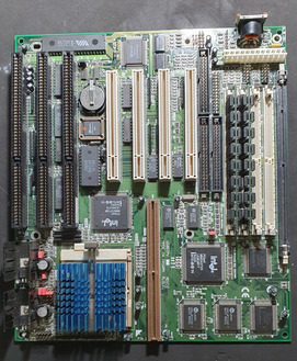

I've got a CPU speed problem the CPU is an Intel 200MHz MMX BP80503200 SL23S/2.8v and the motherboard is a DFI G586IPV Rev.C
I've set the jumpers on the motherboard from the manual and its getting a post CPU speed of 166MHz, the motherboard has the two power regulators next to the CPU with the extra jumpers for setting 2.8v (MMX) JP11, JP20 and JP21 compared to some of the versions of this motherboard without these extra jumpers and regulators
I've set JP6 for 66MHz CPU bus clock 1-2 off, 3-4 on.
I've set the multiplier to 3x for JP8 to 1-2 off, 3-4 on.
I've set the voltage to 2.8v (MMX) JP9 1-2 on, JP11 1-3, 2-4 on, JP20 3-4 on, JP21 1-2, 3-4 off.
I know the bus clock works on JP6 because if I set it to 50MHz clock it posts as 100MHz for 2x but 125MHz for 3x and 100MHz for 3.5x, if I set the clock to 66MHz and 2x it runs at 133MHz and if I set it to 66MHz and 3.5x its still at 133MHz so the 3x and 3.5x multiplier is off. I reseated the CPU and now thats all I can think of to try
It has an Award Modular Bios v4.51PG at post and in the bios is Rom PCI/ISA Bios (2A59GD4F) I think this is the latest bios all though I'll try a newer one if there is one.

Reply 1 of 9, by Gmlb256
The CPU is actually running at the specified CPU speed (except perhaps when selecting the 3.5x multiplier), it is just that during POST it doesn't display the correct frequency which means that the motherboard may don't actually have the latest BIOS. This can be somewhat checked by looking the date at the bottom of the POST screen.
Reply 2 of 9, by GabrielKnight123
During post at the top for the year under the bios version v4.51PG is 1984-96 and at the bottom of the screen is:
09/23/96-i430VX-W877-2A59GD4FC-00
I have tried a known good Pentium 200mhz mmx from another board and its the same, speedsys and other programs say its only running at 166mhz but at least speedsys reports it as a P554c
Could there be a different jumper setting than the manual for the multiplier? I'm still holding back on that though ide like to know about the bios first

Reply 4 of 9, by zyga64
There is a difference between P54C (non MMX) and P55C (MMX) in interpreting multiplier.
Please watch this great explanation from Scorp: https://youtu.be/J0NLGfocviU?t=282
But this can be remedied by soldering a resistor - details also in this video 😀

Reply 5 of 9, by H3nrik V!
Jumpers are directly connected to the CPU's BFx pins - it shouldn't be BIOS dependant, only if the correct speed is shown at POST or not. But if softwares show that it runs at 166, that's probably the case. I would probably try some other multiplier settings to see if they'd work. Until you wrote that you tried a known good 200 with same result, I was considering, that you might have a counterfeit 166 with locked multiplier, but that doesn't seem to be the case ...
Reply 6 of 9, by GabrielKnight123
Thanks for the video zyga64 I'll look into adding a resistor on the BF0 to see if it helps but I might need some help with which of the jumper legs to use on this motherboard I can find the BF0 pin on the underside of the CPU socket though, zwrr the setting for 1.5x uses the same jumper setting for 3.5x JP8 1-2 off, 3-4 off, it runs at 133MHz for both settings its a bit strange that there is one settings for two multipliers
Reply 7 of 9, by zyga64
GabrielKnight123 wrote on 2023-11-21, 11:45:
It's by design. Because processors which supports x1.5 doesn't support x3.5, and vice-versa.

Reply 8 of 9, by Gmlb256
GabrielKnight123 wrote on 2023-11-21, 08:00:
Definitely not the latest BIOS for that motherboard.
There are later ones which can be found here, yours has the COAST module so pick the one mentioning 07/31/98-i430VX-W877-2A59GD4FC-00.
Reply 9 of 9, by Sphere478
I have noticed that sometimes the multiplier settings are sometimes scrambled on locked p1 mmx cpus
There are two registers you must fiddle with
Bf0, and bf1
You should also make sure these pins are pulled high when pull low (jumper) is removed
You can remove cpu and measure these pins for 3.3v with mobo turned on and bf0,1 jumpers removed.
You can check them again with mobo off and jumpers installed for continuity to ground (black, negative)
Past that, if that checks good just fiddle with those settings until you get 200mhz as I said some of rhe locked cpus had their multis scrambled.
I have some same S-spec cpus that between three different specimens will give three different multipliers without changing the mobo 🤣
