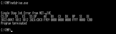

Reply 18 of 432, by Jo22
Yoghoo wrote on 2023-12-12, 10:26:
Tried it today with devload and sysload to start netdrive.sys from the command line instead of the config.sys.
That's interesting. Just tried NetDrive just for fun in DOS Plus 1.2..
netdrive.exe crashed;
The attachment dp12_netdrive_exe.gif is no longer available
netdrive.sys didn't work, either. I tried to use devload, since I believe DOS Plus doesn't load DOS drivers (since it's CP/M-86 really).
Unfortunately, my copy of devload says it needs DOS 3 to 6. drvload says it needs DOS 3, too.
DEVLOAD.EXE v3.12 (C) 1992 - 1998 David Woodhouse. <Dave@imladris.demon.co.uk> Loads device drivers from the command line. […]
Error: This program uses version-specific information, and
only supports MS-DOS versions 3 to 6.
DRVLOAD requires DOS 3.0 or later
Of course, that's all too understanding. DOS Plus isn't a real DOS, after all.
But still, I felt like I have to test this. DOS Plus shipped with the Amstrad/Schneider PC1512 and PC1640.
So it used to be a very widespread DOS 2 compatible OS here in Europe.
Even though that MS-DOS 3.20 was also included, along with GEM.
