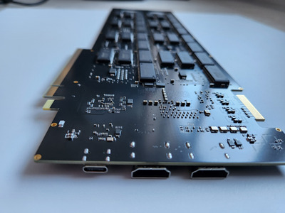

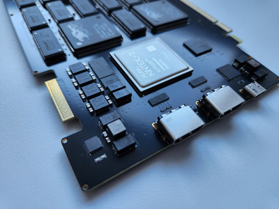

First post, by sdz

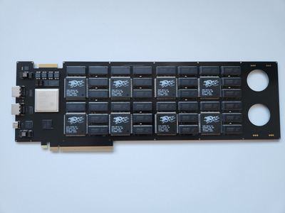

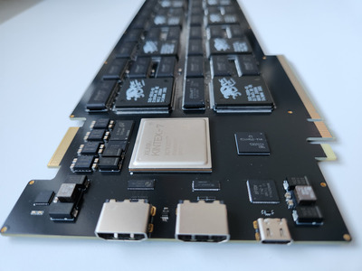

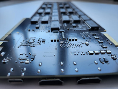

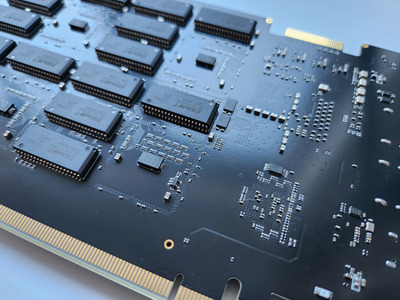

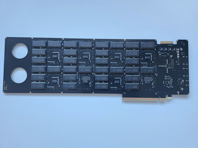

To mention a few things:
-does this look like something made by Captain's Workspace? Yes, yes it does.
-it's not yet functional, the FPGA is blank, I just finished assembly.
-is that specific FPGA overkill for what it needs to do? Yes, I just had quite a few laying around. The FPGA replaces the two RAMDACs, handles the HDMI output and could be used for future expansion.
As for specs:
Basically V2 with 1 extra TMU, in SLI, PCIe interface (PCIe to PCI bridge), HDMI output with HDMI passthrough, and an expansion connector for future use (4 high speed transcievers are routed there, and the FPGA has 512MB DDR3 for.. stuff).

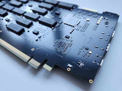

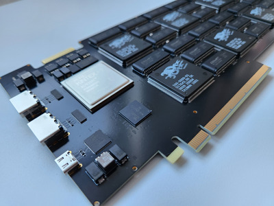

And some more:
1.09 MiB
4082 views
1 MiB
4082 views
1.43 MiB
4082 views
1.1 MiB
4082 views

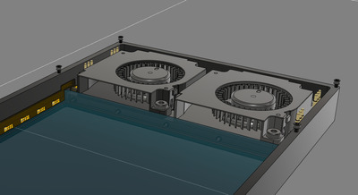

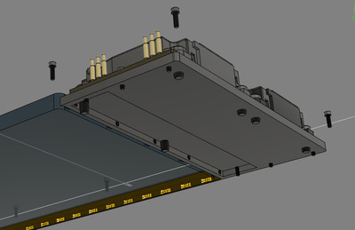

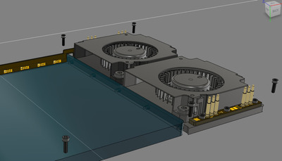

The cooling system is not here yet, but it will look something like this:
223.82 KiB
4082 views

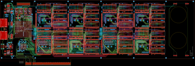

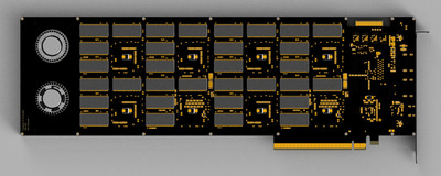

Reply 2 of 88, by sdz
100.19 KiB
4075 views
65.06 KiB
4075 views
99.45 KiB
4075 views
269.39 KiB
4075 views
242.84 KiB
4075 views
Reply 3 of 88, by hard1k
That is absolutely awesome. Love those overkill period incorrect solutions based on some original components and pushing them to ridiculous limits! I'm absolutely after one of these once you release it!
Fortex, the A3D & XG/OPL3 accelerator (Vortex 2 + YMF744 combo sound card)
AWE64 Legacy
Reply 5 of 88, by sdz
@hard1k thank you! That was the idea, to push the V2 as far as it can go, while being able to use it in a modern system.
@xelizor I won't be selling this, and I doubt anyone would want one, it's quite expensive to make one. I do plan to release the files after I get it working.

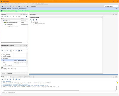

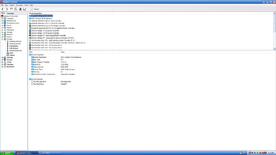

Today I resumed working on this, and did a minimal bring-up.
Programmed the microcontroller that does the power sequencing, brought up the board and all power rails (11 or so) are OK.
Also programmed the onboard FTDI IC that works as a JTAG for the Xilinx FPGA. I had to mess a bit with the ftdieeprom.tcl from Vivado 2023.2 to make it work, since I used a FT4232HA IC and not FT4232H. I can't upload the file here, because of copyright, but if anyone needs info (since there is none on the internet) how to get program_ftdi utility working with FT4232HA, drop a message.
And:

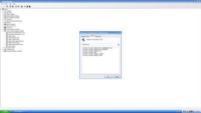

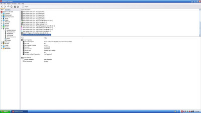

PCIe to PCI bridge is detected:
152.34 KiB
3314 views
As well as:
148.88 KiB
3314 views
127.09 KiB
3314 views
The FPGA is detected and is working:
156.96 KiB
3314 views
Sweet. Now I need to learn some Verilog to make the thing actually work.

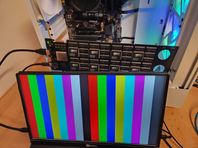

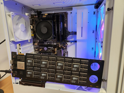

Another small update, got video out:
1.13 MiB
3253 views
It's internally generated in the FPGA, it's not video data from the FBIs.
Now I need to measure default FBI video clock and FBI+TMU memory clocks on a regular voodoo 2 so I can configure some MMCMs and feed those clocks.
After that it should detect the FBI&TMU memory size in the control panel.
Also need to disable the RAMDAC for the start of the system power-up, so that those clocks are delayed a bit, and check if everything is still working fine. This is because the FPGA takes a bit to load its configuration.
Might be better to just check if the FPGA finishes loading its configuration before the system PCIe reset signal is deasserted.
Still ways to go.
