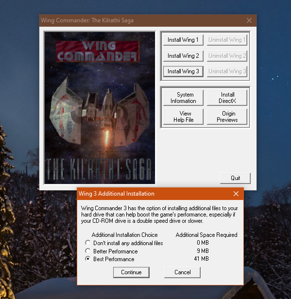

I installed Wing Commander 3 from the Kilrathi Saga pack:
But when I start the game by WC3W.exe (or from the launcher you linked) all I get is this (WC3 CD is in the drive, otherwise it does not even start up):
and I cannot proceed. I guess I'm doing something wrong but I don't know what. The same is when I apply the Win2K patch to the game.

Install the DOS release from GoG and use the kilrathi saga patch i gave to destro https://www.wcnews.com/chatzone/threads/wing- … d.30387/page-11
it converts the DOS release into windows
I followed the instructions here:
https://www.wcnews.com/chatzone/threads/wing- … -10#post-416550
So, installed Wing Loader 0.91, installed the GoG version of Wing Commander 3 into the root folder of WingLoader, patched it through the Wing Loader application.
But I still cannot launch the game. wC3W.exe throws an error about missing files on HDD and no cd found either.

Hi!
Thanks for your help! Meanwhile I figured it out though. I did the mistake that I installed the GOG version into the root folder of WingLoader.
But WingLoader copies the patch files into the root\Wing Commander III.
So, I installed the GOG version into there as well and now it works.
