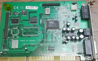

Wanting to get an ISA sound card bought the BTC 1853/1855 on ebay. But Im running into problems and have couple of questions.
1) Noticed that it has jumpers in the left corner but I'm not sure of their function. Can't find a manual either. Could these be for an amplified output? I watched Phil's video discussing ESS1869(?) and he mentioned that the sound card has amplifier jumpers for powered or non-powered speakers.
2) Downloaded Win95 driver's from Phil's website but not sure how to install the drivers. Do I place all these files *.drv, *.vxd and *.inf files in the Windows/System folder?

Don't worry about the jumpers.
https://www.vogonsdrivers.com/getfile.php?fil … menustate=51,41

I recently bought a similar card with a jumper in one of those positions, and was getting no audio out. I traced the header and found they're connected to pins on the ES1868F meant for hardware buttons for volume up/down/mute. They're shared with pins that read the ISA PNP EEPROM which is the nearby chip just under the "96". Pulled the jumper off and it worked fine.
