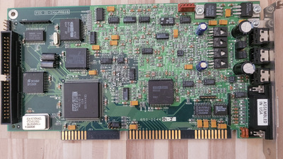

I buy two Media Vision Pro Audio Spectrum 16 card, and have some interesting problem with both cards.

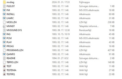

The pas16 installer file list attached.
Have someone idee, with which init software can i best result achieve, and is any 3rd party mixer software, because the command line pas.exe is too difficult, and how can i set up sound card to sound clear, and music/digi sound with equal volume?

The jumpers setted up correctly?

Reply 2 of 4, by envagyok
The 0022 revision board more louder with the 0044.
Is this normal?
Snd 0022 revision board gor example with Descent at opl3 music (pas16 sb16) only from left speaker i hear.
The digital sound ftom descent i hear from both speaker.
This embedded amplifier possible turning off?
There at line out both card has a jumper block, maybe there?
Possible with Sound Blaster Pro CT1330A together build a dual soundcard setup?
Reply 3 of 4, by Grem Five
Your 0022 has factory settings of J10 jumper set to 220h and J12 jumper set to IRQ 5 (pins 3-4 closed). The 0044 these settings should be set by software.
The jumpers behind the sound jacks are connected to the sound jacks but are only listed as factory setting do not change. I dont remember if any of them can be removed to disconnect the amplifier circuit but I do know if you remove certain ones you can remove all sound out to the jacks, one is for left speaker and the other is right speaker. Those jumpers and the way they work has confused me but I have tried to chase them with a multi meter before.
