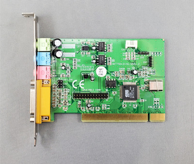

1.28 MiB
678 views
I'm trying to test the SB-Link connection with a Terratec branded ESS Solo-1 card.

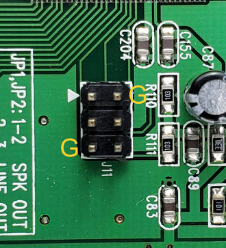

I looked up the standard SB-Link pinout and confirmed the motherboard SB-Link header matches with grounds on pin 2 and 5.
On the ESS Solo-1, the pinout appears different. There is a ground on pin 5, but also a ground on pin 3. Pin 2 is not grounded.

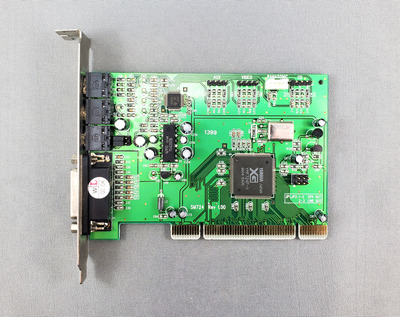

I compared this with a Yamaha YMF-724 card. On its SB-Link connector the grounds are on pins 2 and 5.
1.63 MiB

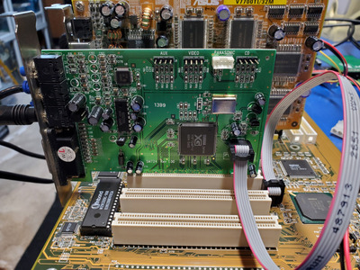

995.14 KiB
678 views
I tested the Yamaha card and confirmed it does work. Software is set to PC-PCI mode and sound works perfectly. I also checked the cable I'm using to confirm the pins are the correct layout on the connectors.
On a whim, I decided to try the ESS Solo-1 with the same cable . The system fails to even power on suggesting it's probably shorting to ground.

We have basically the same card then. All I did to mine was add a wavetable header, but that shouldn't impact the SB-Link...
I may have to get my hands on a different Solo-1 for comparison.

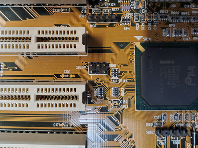

And lastly, if it helps, here's a pic of my Abit ZM6 motherboard. The SB-Link header (slightly to the right of the ZM6 marking) doesn't have Pin 3, just like in @gerwin's schematic. I checked the manual and there is no pinout listed, it just says be careful not to attach the cable the wrong way.

The motherboard I am using is indeed a ABit BE6-II.
The SB-Link header is missing pin 3. And I confirmed with a multimeter that pins 2 and 5 are ground.
This matches the Yamaha card I tested originally and which works.
