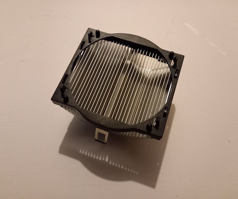

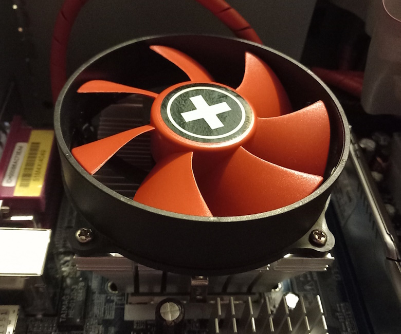

My retro PC has a socket 462/A CPU, the cooler is very loud, I found a brand new FM2 CPU cooler in a cupboard and was thinking about taking the fan off it.
The problem is, the fan on the FM2 CPU isn't in a square case, it's round, here is a picture of it fitted on to my 462 cooler...
Here is the FM2 cooler without the fan...
Here is my original 462 cooler fan...
As you can see, because the new fan is not squared, there is a gap around the sides of the heatsink, does this matter? or does it need a plastic frame like the FM2 cooler has on?

That fan's going to work absolutely fine, enjoy the lower noise 😀
It will matter a little. Most of the airflow from a fan is towards the outer edges of the fan blades / the sides of the casing. As such, most of the air from the fan will likely slip past the heatsink and not much will go through it. Of course, depending on the CPU that you have under (particularly its TDP rating), this may or may not be an issue - i.e. if the CPU has low TDP, the heatsink may not need that much air flowing through it to keep the CPU cool, so the new fan might be just up to the task. However, if the CPU is a higher-end chip with TDP of 55+ Watts, your new fan might not actually be able to provide the airflow needed to keep the CPU cool... or rather it will provide the airflow, but since the air won't be directed to pass through the heatsink fins, the heatsink won't be able to remove heat as effectively as it would with the old fan.
So in short, you would have to test this and monitor your CPU temperatures carefully.
If you are handy, one thing you can do is you can make your own "adapter" to go from the width of the new fan to the width of the heatsink, sort of like a funnel. I've done this many times in the past when fitting larger (80 mm) fans onto much smaller (stock socket 370) coolers in order to get rid of the loud 5k RPM screamer fans that those coolers came with while still getting the same cooling capacity.

The original cooler is a similar size to the FM2 one so I may be able to get the plastic trim part fitted onto it, I will try it this evening,
