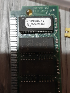

I have a weird situation where only the first slot is working. I accidently bought parity EDO and now only bank 0 is works. Is it the parity issue or could it be the motherboard?
The motherboard is a ABit AB-PG5 and the memory is in the picture.
Is this something someone has seen before?

- how many SIMMs of the type you photographed (32MB parity, with 18 4Mx4 chips) do you have?
- when you say "the first bank works", which SIMMs are in which slots?
In any event, so long as SIMMs are identical, the presence or absence of parity support on the SIMMs will not cause issues. If some SIMMs support parity and others do not, you should disable parity in BIOS. Then all will work the same. If you have parity enabled in BIOS but some SIMMs do not support parity, those SIMMs will not work so long as parity remains enabled in BIOS.

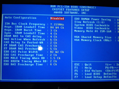

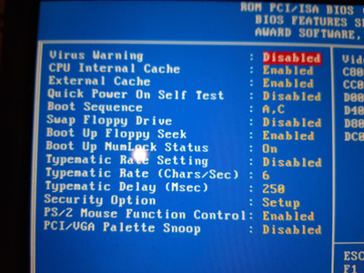

I can't find any option with respect to parity in the BIOS. That is one of the problems. The Micro House Encyclopedia of Main Boards sheet only lists 8M x 32 and these are 8M x 36. I thought that was just the parity speaking.

I do not think the board likes those simms. I bet if you tried some 16MB 8 chip EDO matching they would work....fwiw: I do not have any EDO parity in all my bags of simms but do have some EDO ECC simms...
That may not be the issue and could be the board but I still would try diff simms.

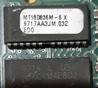

added: Another interesting issue is the part number on sticker matches Micron for FPM ECC, not EDO. see: https://digchip.com/datasheets/parts/datashee … D836-6X-pdf.php
I never thought to look this up, I supposedly bought EDO parity but never thought I would get FPM ECC.

Yep, think your simms are specific for a server type board (checked and appear they are EDO plus ECC/Parity) and will not work as expected in a standard board.
Remember getting some dimms like that once, did not work proper in standard boards. Sorta along the lines of those simms with presence detect...in reverse..

I'm going to update the BIOS and hope it is a bug limiting it to 32 MB somehow.

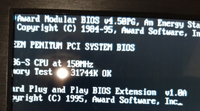

Okay this is weird, like the machine is limited to 32 MB but there are no jumpers or settings.
One 4 MB in slot 1 and one 32 MB in slot 3 is 32 MB on boot.
One 32 MB in slot 1 and one 4 MB in slot 3 is 32 MB on boot.
This means neither slot is defective and the machine sees both banks.
I did find one bad trace going to a slot but when I connected the trace on boot, it didn't change anything.
