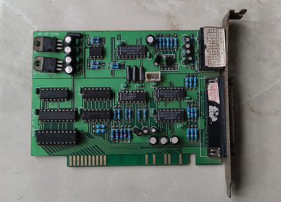

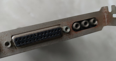

The seller said it was a ordinary sound card.But I found something wrong.
the interfaces, including the game controller interface.,I don’t recognize .
where is the DSP and Codec?

HEF4053BP datasheet. I guess they might be using those in conjunction with a six-resistor ladder as 6-Bit ADC/DACs? Which would make them a quarter the quality of a Covox Speech Thing. Nice.
No idea about the (not-a-)gameport. Maybe it came with an adapter or breakout cable?
Reply 2 of 3, by Tiido
Very interesting device. It uses a very high bandwidth triple opamp LT chip, and it only connects 4 data lines on ISA slot, which makes me think that big connector is for another essential but missing part of the puzzle...
Reply 3 of 3, by qdsong88@
Tiido wrote on 2024-02-29, 11:06:
maybe you are right , thx!
