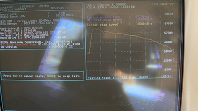

Reply 9 of 21, by Marco
douglar wrote on 2024-03-04, 21:46:
Marco wrote on 2024-03-04, 21:37:
It’s at 13,75 MHz
I usually expect get 1300KB/s -1600KB/s on an 8MHz bus, so 2600KB/s on a 13,75 MHz bus sounds about right to me.
And speedsys is reporting 3600KB/s on that same system with the Maxtor IDE? That's awesome. Can you post a screen shot?
On older screenshot with an older drive already close
1) VLSI SCAMP 311 | 386SX25@30 | 16MB | CL-GD5434 | CT2830| SCC-1 | MT32 | Fast-SCSI AHA 1542CF + BlueSCSI v2/15k U320
2) SIS486 | 486DX/2 66(@80) | 32MB | TGUI9440 | SG NX Pro 16 | LAPC-I

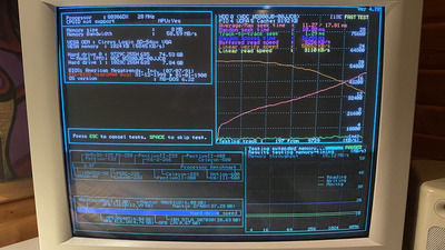

Reply 13 of 21, by Marco
Here the latest screenshot

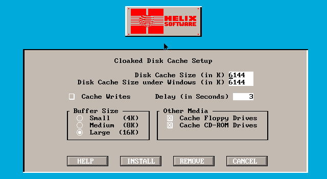

Reply 17 of 21, by Jo22
Hi, I know this isn't exactly a solution to the problem, but it might be a workaround:
By using ab HDD cache, you can spare the DOM more often.
So there will be less likely a situation in which it gets being overburdened.
On the other hand, though, a HDD cache like SmartDrive usually costs precious conventional memory.
Luckily, the Helix Multimedia Cloaking package has one SmartDrive alternative included that doesn't take up much conventional memory (it uses Extended Memory).
The cloaking manager and compatible utilities once were sold but sometimes also bundled for free with other software, like mice driver software.
If that's not being an option, there is still Central Point PC-Tools (v7 etc), which comes with a tiny HDD cache that's still smaller than SmartDrive.
Maybe it will do good enough.
Edit: This is just an idea, of course. No one is forced to try this.
