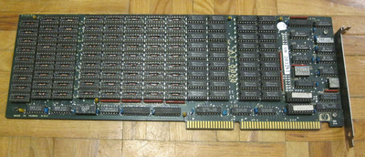

Offtopic: that board has one of the worst possible names for googling info...
Those banks of dipswitches need setting to put the memory in the card at the right addresses for your system, and indeed in the right mode (convetional, EMS or XMS). Those settings are completely specific to the card, so you need the manual for this card to figure it out - unless there are switch settings on the back of PCB 😉
Not had any luck locating info on the board yet (see the offtopic).

ISA XMS/EMS Memory Extension / Expansion cards: Now Running without Driver / Documentation :-)
Follow this instruction and add your card there please.
This card looks easy, only few switches.
