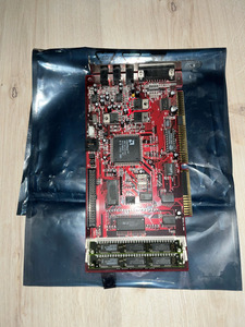

Gents, just now a cap blew off my GUS PnP Pro (the big one around ISA pin 10/11).
Can it be repaired or is it deadge?

why wouldn't it be repairable? i dont see any leakage around it and it's a thru hole capacitor that looks like the specs would be clearly visible.
Reply 2 of 2, by elszgensa
It could have blown for another reason than "being old"... But odds are that's what it was, and replacing it will suffice.
Don't forget to check where it blew up at inside your PC and that clean up.
