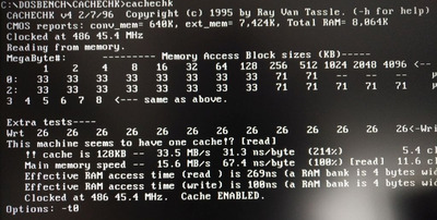

The "interposer" is indeed a Cyrix 487S FPU. So the CPU is piggy backed on top of the FPU.
The bad news is that the system is a bit underperforming. It may be due to the old MB (A Soyo SY-025D1) with an early vlb chipset, but maybe there is more... Even when using the fastest BIOS settings, I've run a few synthetic tests and this CPU seems to be barely faster than a 486DLC (which runs off a 386 bus and not on top of the better performing 486 bus). I've a hunch the internal cache also work in Write Through mode because the motherboard predates the arrival of 486 with WB caches. At any rate, there is also another odd fact... CacheCHK doesn't seem to recognize the 2KB cache at all (see pic). Before working further on this setup, I need to dig up some old utilities for the Cyrix CPUs. The one I used for the 486DLC doesn't appear to be working with the 486S.

The last line says "clocked at 486 45.5MHz. Cache ENABLED."
I take that to mean the internal cache is in fact enabled.
Cyrix had writeback cache in some of their CPUs about a year before intel on the desktop, so that doesn't necessarily mean the cache must be in write through mode. The date code on the chipset is the second half of 1993, which lines up perfectly with the release of the 486S. They most likely worked with a few chipset vendors to make sure the features unique to their CPU were supported. If you want to know for sure, you can dig out the datasheet for the SiS461.
The system running about the same speed as a 486DLC kind of makes sense, as it basically is a 486DLC with an extra 1kb internal cache. They were definitely a notch below proper 486s, which is why this product was not very successful.

You are right. I dug through all my documentation and datasheets and it appears that the 486S has the same core as the 486DLC with a different bus and cache. The later Cyrix 486DX is an improved design that is closer, performance wise, to Intel and AMD 486s.
However, I was also right that the internal cache was working in write-through mode. I found a small utility that lets you switch the internal cache of all Cyrix 486s between WT and WB mode: https://github.com/karcherm/cx486wb
By default, after boot up, the processor cache is set in WT mode. Switching it to WB yields a modest 5% increase in real world applications (I tried with Wolf3D and Doom).
