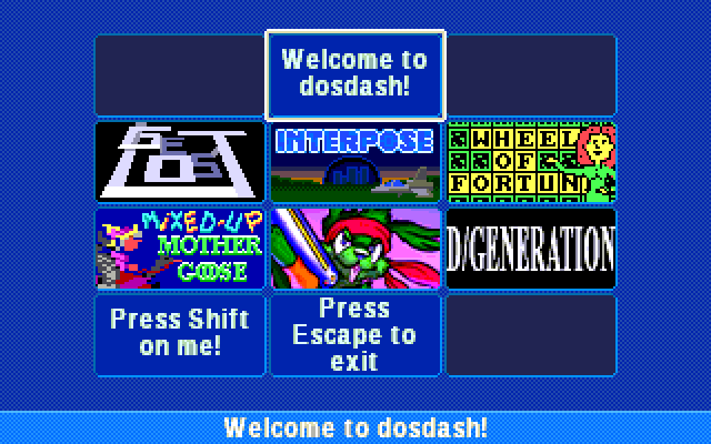

Hello! I've been working on a nice 2010s-style graphical dashboard interface for MS-DOS, as I'm surprised nobody has made one yet. It's simply a grid of selectable pictures in the vein of LaunchBox, the Xbox dashboard, the XMB, tablet devices and so on. It's designed to be very kid friendly (you can't even edit the menu from inside the program), and 'fool proof' for the most part.
Screenshots:
https://www.mrdictionary.net/dosdash/download … t20240404_1.png
https://www.mrdictionary.net/dosdash/download … t20240404_2.png
Here is the introduction from the readme:
dosdash is an easy-to-use, family friendly graphical menu program for IBM PC-compatible computers running MS-DOS. It provides a […]
dosdash is an easy-to-use, family friendly graphical menu program for IBM PC-compatible computers running MS-DOS. It provides a familiar 'dashboard' style interface, giving you simple quick access to all your games.
dosdash displays a grid of beautiful image tiles representing the games on your MS-DOS system. You can navigate the grid using the keyboard or gamepad. Over 200 games can be set up in the grid.
In addition to a standard 'Action' for each tile, you can give each tile a set of its own extra Actions that will be shown in a sidebar menu. You can use this to provide ways to access sound card setup programs for games that need them, or ways to access extra episodes or mods of games without using multiple tiles.
For example, you can have a tile for Duke Nukem 3D which launches the main game when selected. In its Actions menu, you could have additional items for 'Setup Sound' and 'Launch Build'. For your Quake tile, you could have seperate actions for 'Quake', 'Dimension of the Past', 'Dimension of the Machine', 'Shrak for Quake', 'Malice: 23rd Century Ultraconversion for Quake' and so on. Or, you could choose to give each Quake total conversion its own graphical tile. The layout and content of your menu is up to you.
dosdash unloads itself completely from memory when launching a game, so does not take up any conventional memory when launching a game.
dosdash can be ran from the commandline, or included in your AUTOEXEC.BAT to provide a self-contained friendly menu experience.
dosdash is designed for use on real MS-DOS computers. However, if you prefer, you can install dosdash within DOSBox, if you prefer to have a single DOSBox configuration for all your games instead of multiple configurations.
You can launch Windows 3.11 from dosdash if you like.

Reply 1 of 17, by MrD
Here's a different screenshot showing some possible icons: https://i.imgur.com/3KwB2A5.png
And here are the corresponding GRAPHICs if you'd like to try them out.

Reply 2 of 17, by elszgensa
Nice. I don't see me using this a lot since I actually like the command line, but I bet there's enough young'uns out there that don't and just wanna play already and will appreciate this.
Some things I noted:
- The first thing I did was disable sounds, since I don't like my interfaces to go DINGDINGDINGDINGDING while interacting with them. Maybe a "less noisy mode" with sounds just for certain, special actions?
- Unlike everything else, very long menus (like your "press shift on me" example) do not smooth scroll, which was a bit jarring. Then again, one could just refrain from making menus that long... meh.
- A way to control animation speed/disable them entirely would be nice. It felt ever so slightly sluggish. And I mean "felt" since afaict changing focus is instant, it's just the cursor that's lagging.
- Entirely optional, but I think adding a panel showing a snippet of free form text (say, two or three lines below the title) could be useful, for things like genre, year, whatever - avoids having to press shift on every entry.
About the tile size - The current one seems fine to me. But maybe slightly smaller ones in a denser 4x5 grid might be nice too.
Edit:
- Invalid corrupted base64 tile data (I tried corrupted invalid characters and duplicated lines) makes that tile look wonky, which is fine. However, not enough data (but still properly "ENDGAME"-terminated) makes the entire database not load, which isn't. If you expect users to copy tile data via forums etc, someone down the line will mess up.

I should possibly make the default created .INI default to no sounds, just like it defaults to no gamepad, because yes it can be annoying and I don't have a frame of reference for the volume (I'm manually poking Ad Lib registers - I was surprised I got it right at all! I don't have a tool like my YM2612 editor yet to tweak the patches to make them pleasant).
Hmm, I am surprised the side menu doesn't smooth scroll. The entire interface is a Mode X screen so when you press Shift it's moving the displayed screen to the side just as it would if you were scrolling a long wide grid horizontally. Are you saying that the animation is slow, or it happens instantly, or it's inconsistent? What system/emulator were you using? Ah you mean the items -within- the menu. Yeah, there's nothing I can do about that because I can't hardware scroll that side bar independently of the body of the screen. The side menu is the closest thing to an 'advanced' feature dosdash has, and you have to have quite a few items to make it scroll (more than nine, off the top of my head? Though the items do wordwrap if you've noticed 😀 ), so dosdash 'power users' might forgive it being less glossy an interface than the main tiles. 😜
I think I should expose cursor speed in the INI. As it is, I picked a speed that was a little slower than one I'd normally choose, since I like things to be snappy, but users might find sudden scrolling jolts disorienting.
Having the freeform text or fields was something I debated a lot. I know someone who swears by the Kodi media player for example, and that system has so many different views for looking at tiles, sorting and so on. The two problems I might have with that is that the database gets more and more messy to scroll through (it's not a perfect system as it is...) and also font rendering is awkward in Mode X.
I considered smaller tiles (but then I'd be treading on the toes of more desktop-like interfaces where the icons are square) and larger tiles (Xbox 360 NXE style four-in-a-row was an option, but I wanted more than four games on screen). This layout is more intentionally Glance-like, and the size was chosen to get a lot of tiles on screen but also have a 4x5 grid slightly overhang to suggest to the user that scrolling was possible. I was also sort-of channeling the interface to Putt Putt and Fatty Bear's Activity Pack, which I had as a kid, though I only noticed the resemblance when I was done. Edit - I don't recall the reason why the interface is 320x200 instead of 320x240, which would have allowed for more tiles. Perhaps I did a calculation at some point and worked out that would get me 9 tiles vertically in video RAM without resorting to page tricks like Jazz does (and my own platform engine does).
Not having sorting for example was a combination of imitating Glance, laziness and simplicity. It's supposed to be more like Super Mario All-Stars (again, four games in a row) than a full management program.
Reply 4 of 17, by MrD
What sort of frame rate are you getting, and on what system?
I've tried it for myself for the first time on a real Win 98 system with a Geforce FX5200 AGP 128MB and an Athlon XP 2500+ and it's running -terribly- heh. It's supposed to be 60fps, not 15fps... Haven't got a clue why it's doing that. But it does run (function) correctly from windows or the prompt. I'm hoping the slow graphics performance I'm seeing is due to the AGP card's best effort performance at trying to do unchained mode.
Reply 5 of 17, by leileilol
I know nVidia Geforce cards are slow with palette changes so I hope you're not doing that for every frame.
long live PCem
Debian's fucked
Reply 6 of 17, by MrD
leileilol wrote on 2024-04-09, 05:03:
I thought I was, but I'm not. I'm only changing the palette during the fades into and out of the interface. If the palette doesn't change, it isn't written.
I swapped out the FX5200 for a Trio 32 and it's exactly as slow as it was before. Maybe I'm detecting vertical blanks or changing the screen address at the wrong time.
Reply 7 of 17, by dukeofurl
Really cool idea! Would be perfect for if you were trying to configure a gaming pc for kids, or someone who didn't grow up with dos but still wants to play the games.
Reply 8 of 17, by VileR
Looking good! My impulse would be to swap the font for something more tailored to low-res, which wouldn't require quite this much anti-aliasing, but that's just me.
Also: +1 for featuring Get Lost. 😀
Reply 9 of 17, by MrD
You're right VileR, the font isn't perfect. I was working on a different Mode X platformer engine with text captions and reused the font rendering and the rasteriser from there. I'm hoping that as I improve dosdash, putting a new hand drawn .chr in there will work seamlessly rather than blowing everything up. As it is, its legible enough. It originally used 8x8 bios fonts as a placeholder. Also, the limited character set reduces memory usage but prevents any use of accented characters. I may change this, but I suspect that allowing those characters will have frustrating consequences as the characters travel from the generator htm to a text editor and then into dos. I see you have some font tools on your github so that's a good place for me to start 😀
Reply 10 of 17, by MrD
I've gotten to the bottom of the 15fps issue, and it's something that I'd actually already accommodated for! 😁
If you're trying dosdash on real hardware and the menu cursor moves too slow, change gamepad_enabled to 0 (no gamepad reading at all) or 2 (custom gamepad reading). By default dosdash uses the BIOS gamepad reading interrupt, which I was told could be slow. In DOSBox and PCem of course it's an emulated hardware feature so it can be arbitrarily fast. However, if the BIOS call to read the gamepad is implemented, then if you don't have a gamepad (or don't have a sound/IBM GCA card even), then it'll sit there for a long time reading the port waiting for flags to clear that will never be cleared. I don't know how accurate 2 is on hardware yet, this is one of the things that we're currently testing here.
The cursor movement still feels a little delayed, but I think that's the double buffering perhaps, or my LCD monitor. At least it's running at the proper frame rate now.
Reply 11 of 17, by MrD
The gamepad thing being the cause of the slowdown seems to be pretty definite now.
I've uploaded a new version of dosdash which defaults to my reading routine.
If someone with a gamepad or a flightstick could test dosdash on a real DOS machine, and compare performance using gamepad_enabled=0 (then 1, then 2) I'd very much appreciate it!
Any objections to keeping this tile size?
Reply 12 of 17, by MrD
I've now tested dosdash on DOS 4! Seems to work great, though the lack of a full screen text editor makes editing DATABASE.TXT and DOSDASH.INI and DASH.BAT pretty difficult 😉 Anybody running DOS 4 on real hardware tried dosdash?
Reply 13 of 17, by Thraka
I LOVE this menu. Thank you so much! I'm going to start building out some games and stuff. Do you have the source code anywhere? Here are 3 badges for Wing Commander.
Reply 14 of 17, by Thraka
And here are some more for the other expansions.
One thing that would be nice is if I could pass in the path to a database file and have it use that.
Reply 15 of 17, by rfnagel
Sorry for necroing this older thread, but this thing is EXTREMELY cool! I really wish I had something like this back in the day when I was setting up old DOS PCs for my nephew and niece.
Rich ¥Weeds¥ Nagel
http://www.richnagel.net
Reply 16 of 17, by DeFransen
Just found this and it is exactly what I was looking for. 😀
Extra 👍 for self unloading.
But to make it perfect I would have some feature requests:
  • configurable background image
  • customizable cell size - when you have just few items it just looks better with bigger cells
  • completely hide status bar - for simple starter menus this is not necessary
Reply 17 of 17, by RetroLizard
Can the menu be customized to look different, by any chance?
