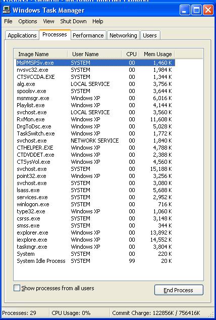

Tried disabling some of the things in the task manager - no joy. Tried to disable more things but Windows got upset and shut down. Enclosed is screenshot from Task Manager before I closed anything. Playlist, DrgToDsc, and stuff are from Easy CD & DVD Creator 6 I think.

Reply 8 of 11, by Glidos
Plenty of possible culprits in that task list. Running XP, I don't have
MsPMSPsv.exe
CTSVCCDa.exe
PlayList.exe
RxMon.exe
DrgToDsc.exe
CTHELPER.exe
CTDVDDET.exe
CTSysVol.exe
point32.exe
type32.exe
Modern printer drivers are a real pain, they seem to take over the whole system, starting loads of background tasks that make things you don't want happen automatically. They seem to take the attitude. "Ah the user is intalling a printer driver, so obviously, form now on, they will never want to use their computer for anything else than printing.
Reply 9 of 11, by Snover
CT*.exe are all Creative services (disk insert notification, other useless shit like that). Turn some off in the Services CPL. (Start > Run "services.msc", Creative Service for CDROM Access) The other ones you'll need to disable stuff that is running at startup. I recommend Mike Lin's Startup Control Panel.
MsPMSPsv.exe is "Windows Media Device Service Provider" -- your favourite company's Digital Rights Management package. "Supports the Secure Digital Music Initiative (SDMI) which is used when packaging copyrighted music." Listed as "WMDM PMSP Service" in Services. Change it to "Manual" or even Disable it altogether.
point32.exe is useless crap installed by your Microsoft IntelliMouse drivers. (Why you installed the drivers I don't know since it's built into the damn OS, heh.)
Anyway, there's everything I can identify off the top of my head.
And, you can't Alt+Tab or Ctrl+Alt+Del? Sounds like a PollPipe.dll runaway process. Paul, did you change the PollPipe's priority back to something intelligent (Normal) for the 1.19 release?
Yes, it’s my fault.
