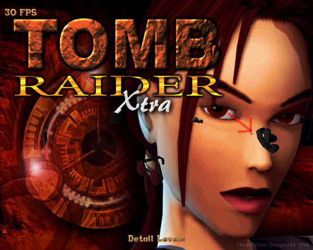

Reply 7 of 109, by ChaosFish
Gambit: really beautiful!!
Only it has a little glitch. On Lara's nose.

Reply 8 of 109, by Gambit37
Yup, I know about that, see here:
showthread.php?s=&threadid=2578
Hopefully Paul can fix this in the next version of Glidos, as it's not a problem with the actual graphics, but the engine itself...

Reply 12 of 109, by Glidos
I've just looked at your example screen shots. I think you've updated them: I was impressed before, but the ones you have up there now are incredible. I really didn't expect to see this done so well.
I'm looking at the corner glitch problem now.
Reply 13 of 109, by Glidos
I've fixed the glitch. It was a bug in OpenGLide. If you drop the attached new version into your Glidos folder, the glitch will go.
