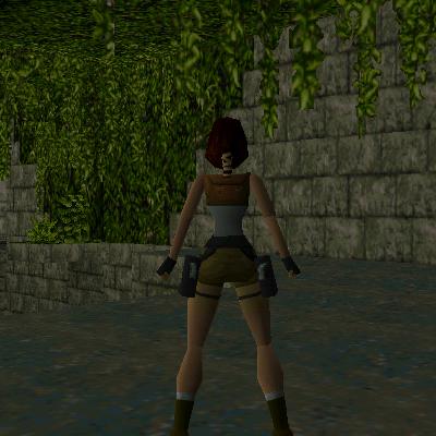

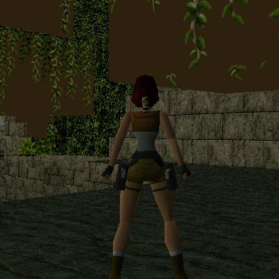

Ummm.. to clarify the last post - High res textures show brown, normal res do not. This happens even when just pressing F4 to toggle between the modes. (See attached screenshot croppings).
    25.39 KiB
    944 views
    ..to this, without even shutting down.
    26.28 KiB
    944 views
    Toggle F4 from this..
Reply 6 of 7, by Glidos
Aagh! Yes of course: that version doesn't support 16bit chromakeying.
Matthew and I are working on a whole lot of new stuff for texture override, and the next release wont need 16bit chromakeying. If you don't mind waiting a little bit...
