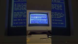

I've also tested it on my actual 386 hardware which works, which is a relief!
https://youtu.be/Pf-mYUyjb7U
