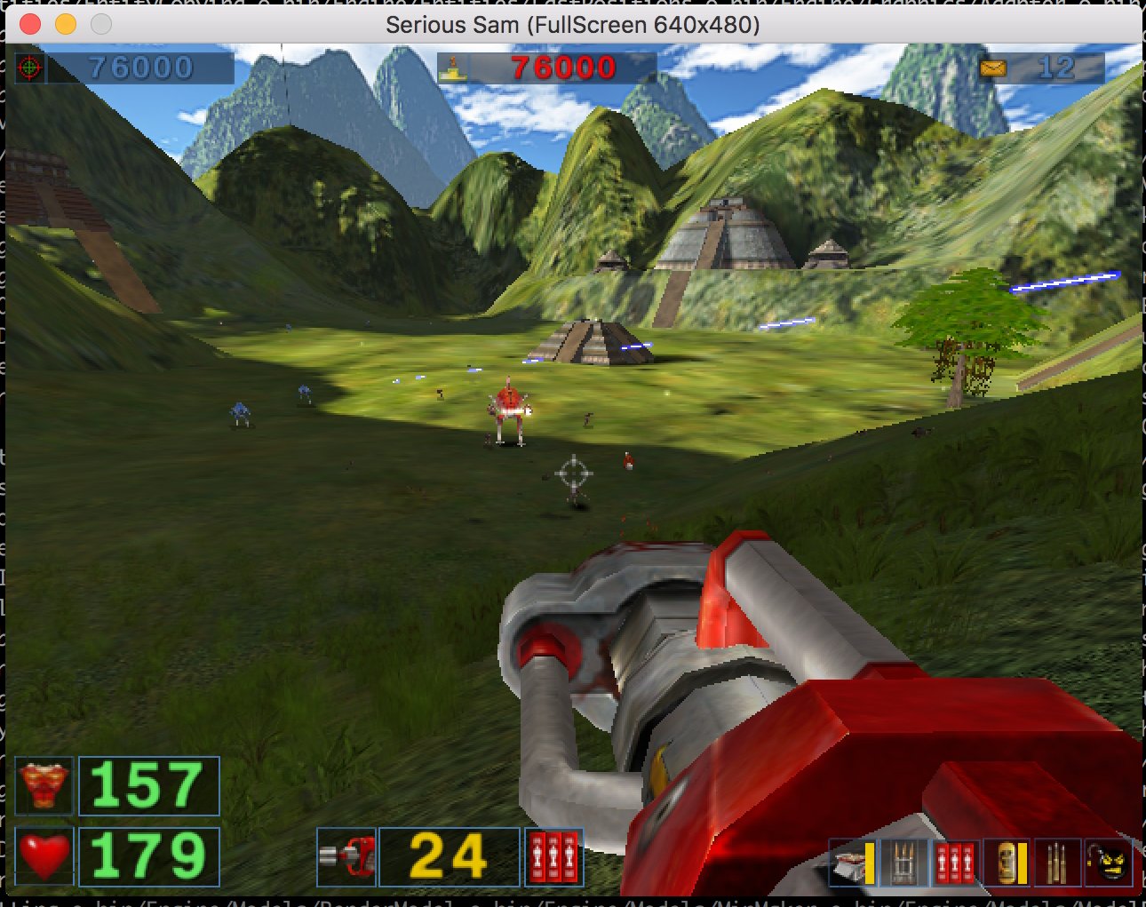

Mr. Gordon has advanced the Linux port (and I think OS X and possibly FreeBSD):
https://github.com/rcgordon/Serious-Engine
Here is an extraordinary port for OpenPandora (not x86 but ARM based Linux):
https://github.com/ptitSeb/Serious-Engine
The author also has a couple of threads which provide further details:
https://pyra-handheld.com/boards/threads/seri … ncounter.77225/
https://pyra-handheld.com/boards/threads/seri … ncounter.77226/
Here are x86 fixes by notaz, but should be combined with rcgordon version:
https://github.com/notaz/Serious-Engine/commits/asm_fixes
There is a branch for mingw (Windows) which complements the original source release using Visual Studio, but it is not finished. The above ports also don't test in Windows, so recent additions will eventually make it more difficult to port the Linux/SDL version to Windows/SDL. As additional SDL ports are added, then it should make the overall code more easily adapted to future SDL platforms.
These SDL ports are actually reliant on SDL2 code, although the rcgordon port has SDL1 code at a specific commit level. This is for porting to SDL1 specific platforms which are not represented by SDL2, but perhaps this set generally does not have the performance necessary to run Serious Sam.
