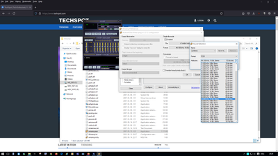

Reply 1370 of 1508, by Falcosoft
stgiga wrote on 2022-08-13, 16:10:
Winamp (including the 2022 version) has 24-bit ACM support....
I have just downloaded a portable version of Winamp to check this but I could only find the same ACM interface as Midi Player uses and that is only capable to record in 16-bit maximum...
228.23 KiB
1407 views
@Edit:
I have made some experiments and it seems that at least under Win10 (since the audio engine is fully floating point) I can request WAVE_FORMAT_IEEE_FLOAT as a valid recording format even through DirectSound capture.
So this way maybe I can implement direct 32-bit floating point wave recording through DirectSound completely bypassing ACM the same way as in case of Bass based recording.
Website, Facebook, Youtube
