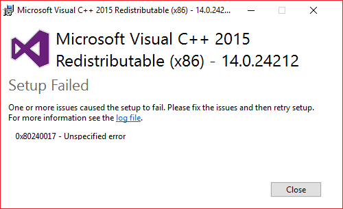

Yes, it has and it always has had the option. The problem with the new refactored dynamic runtime of VS 2015 is:
1. It has a tendency of failing to install (mostly on Win 7) with error code 0x80240017 Unspecified error:
https://answers.microsoft.com/en-us/windows/f … ae-4d4847937ccc
https://techcult.com/wiki/fix-microsoft-visua … ror-0x80240017/
And troubleshooting this error is not straightforward to say the least.
It's mainly because Universal CRT is a system component on some Windows versions but not on others. If you ask me with this refactoring the situation is worsened compared to earlier versions
contrary to the intention to make things simpler and better:
https://devblogs.microsoft.com/cppblog/introd … -universal-crt/
2. At first app local deployment of VS 2015 runtime was not even supported at all but later (mainly because of pressure from developers) they added it but the implementation is way worse than before. To support all possible systems you need more than 40(!) different dlls compared to the 2-3 in previous versions.
https://stackoverflow.com/questions/32601941/ … ocal-deployment

The reason I removed the statically linked runtime is because when linked, the .exe would trigger 15-20 false virus positives on virustotal (yes, really). People would complain about it all the time, and I don't want less people to use my projects because of false virus positives.
Btw, the runtime installer (which is linked in readme_now.txt in the release zip) installs fine on Windows XP, so I don't see the problem.

Hi, the problem is not with XP but mainly with Win7 systems. I personally met some where the installation failed with the above detailed error. Not to mention using your FT2 on systems where you do not have permission to install system components...
Maybe as a compromise you can make a separate downloadable package with the app local distributable dlls that one can copy next to your executable (even if there are many of them).

With the latest version of the PT2/FT2 clone that I released today, I updated the "readme now.txt" file (inside the release zips) with an URL to a zip that contains the needed x86/x64 DLLs to run it without the runtime installed.
I made a fresh install of Windows 7 Ultimate x64 on a laptop and tested it, and it works there. However, it may fail on XP, Vista and Windows 8...
