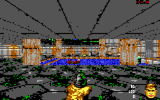

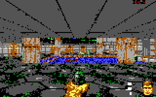

I've finished the precalculated LUT and made it work, the quality is a little bit better but far from perfect. Maybe a better comparison formula could get better results. Anyway, the scripts have been uploaded in GitHub, so anyone can modify and test as wish (the FastDoom rendering code will be uploaded tomorrow when I clean it up). Here are two pictures comparing the original CGA 160x100 mode against the CGA Ansi From Hell 320x100:
5.24 KiB
929 views
FastDoom CGA 160x100
10.32 KiB
929 views
FastDoom CGA Ansi From Hell 320x100
Also video: https://youtu.be/PXU7wiJPndY
https://www.youtube.com/@viti95
