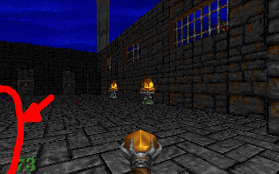

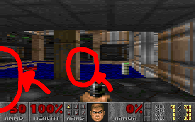

While developing optimizations for Potato mode i've just discovered a bug that I think it hasn't been documented and exists since... 1994 (!!) It just happens that Heretic has a rendering bug on R_DrawSpan (which is ASM optimized and it's much faster compared to Doom R_DrawSpan). It basically renders the first pixel twice and then continues rendering the rest without issues. It's hard to find on a 320x200 resolution, but it becames very obvious on FastDoom's potato mode (80x200):
Here is the bug on Heretic:
34.14 KiB
1403 views
Heretic bug
1.04 KiB
1403 views
Heretic bug zoom
And here is the same bug on FastDoom's Potato mode:
18.27 KiB
1403 views
FastDoom potato's bug
2.38 KiB
1403 views
FastDoom potato's bug zoom
Right now, the bug has been fixed and these are some performance numbers:
FastDoom 0.9.1: 27.632 fps
FastDoom 0.9.2: 33.860 fps
This is 22% faster, on a 386DX-40 (Ultimate Doom timedemo demo3, fullscreen+HUD and no sound). And here is the cool thing, the same optimization will be applied for low detail and high detail modes on Mode Y, so expect performance uplift on the next release 😁
