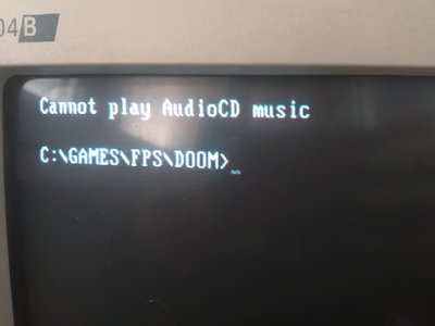

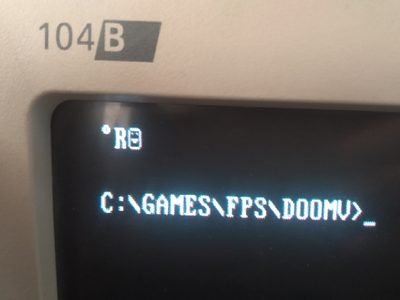

Reply 656 of 984, by theelf
ViTi95 wrote on 2023-01-13, 12:44:
More verbose testing release https://github.com/viti95/FastDoom/releases/d … oom_0.9.3a5.zip. It doesn't change how MSCDEX is initialized but will show a more detailed message on what failed.
Thanks, i attach pictures
Regular build error
292.92 KiB
935 views
Verbose
238.13 KiB
935 views

Reply 658 of 984, by ViTi95
Oops that shouldn't happen 😅. I think I'll write the log to a file and check the whole process better. This weekend I'll be very busy, but will try to get it as soon as possible.
https://www.youtube.com/@viti95
Reply 659 of 984, by theelf
ViTi95 wrote on 2023-01-13, 13:04:
Yes, i realize something was not fine in this verbose build 😀 jaja ok, i will be bussy too until sunday im out for work, but anyways i carry with me my pentium 2 laptop, just in case we need to test jeje
