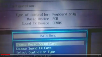

Hi!!! sorry delay to answer!!!
I came here to say THANK YOU! one of my dreams came true, doom in DOS with music and sound in my old Toshiba T2130CS
This nice 640x480, DX4/75mhz 486 dont have any sound card, of course i can use a pcmcia sound, external opl or serial midi, but my dream was just using pcspeaker or a home made covox in real DOS (not a port in windows/linux)
Performance is amazing
TIMEDEMO3 without sound = 30.96
TIMEDEMO3 covox PCM+FX sound 11khz = 25.08
TIMEDEMO3 pcspeaker 1bit+11khz PCM+FX sound = 24.56
WOW!!!
Now using fastdoom i can enjoy my toshiba again, thanks man!!!! i upload a youtube video, covox sound amazing, pcspeaker more or less tolerable, maybe is possible to make pcs sound better?
184.72 KiB
1671 views
https://youtu.be/GQsMOG-N9j0

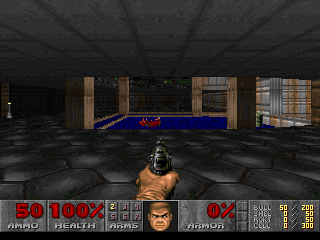

I have a question, a 320x240 mode, with hub on bottom do you think is possible? jaja, to fill toshiba screen and 60hz will be perfect for lcd 😀

The 320x240 idea is good, my Toshiba has the same issue. The aspect ratio won't be right, but at least it will be fullscreen on those devices. I'll try to implement it.
