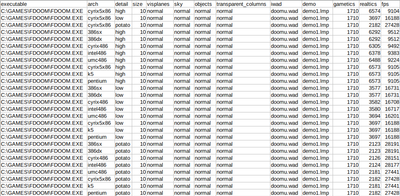

ViTi95 wrote on 2023-05-26, 07:48:
I've discovered that enabling sound makes the benchmark results a bit unstable, if possible execute the with sound and music disabled.
Enclosed are results with sound disabled; my original thinking was that the average user would be using sound so I should test it that way, but yeah with interrupts happening in the background I can see where that wouldn't be desirable while benchmarking.
158.59 KiB
1235 views
Note 1: this is with commit a59723e, not the latest since I built it a few days ago and didn't check for updates until now. But it seems to support removal of some of the Cyrix optimizations in commit 5131989.
Note 2: the first 3 runs were without any arch argument. It seems to default to cyrix5x86? Or maybe selectedCPU isn't initialized and that value just happens to be in memory (from a previous run)?
Note 3: the DOS command line is limited to 127 bytes so some lines in bench.bat get truncated when they're run. I discovered this when I let it run unsupervised and only the K5 benchmark ended up in the csv file (i.e. "-csv" was being dropped). Occasionally it would get stuck playing all the demos when the timedemo option got truncated, too. (It also explains why the cyrix5x86 potato mode benchmark was missing from my previous results.) Does FastDoom support the @<response> option?
Reply 804 of 853, by ViTi95
CODOR wrote on 2023-05-30, 01:27:
Yeah I removed the Cyrix DR0 register use optimizations, they ended up being slower compared to the 386sx (CR2 register) codepath. Which is strange since the datasheets shows that moving data from DR0-3 registers is faster than moving data from CR2 register on the Cyrix processors.
For now I haven't deal with default settings, as there isn't a generic codepath set for now, so better to test with an architecture selected.
Yeah I've been trying to avoid use configuration files for benchmarks (in order to not have lot's of configuration files on the main folder), but I think I'll change this idea due to this limitation. I think the best will be to add a "benchmark" option in the Doom executable, that executes benchmarks internally without having to reload the game each time.
I'll look also the @<response> command line parameter, don't remember if I removed it or not 😅
