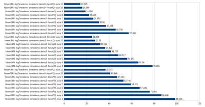

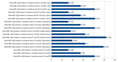

Forgot to post this, I made some benchmarks with FastDoom 0.666 in one of my testbenchs.
FastDoom 386 build, Doom shareware 1.9 WAD, Demo3, default fullscreen + hud.
CPU: Cyrix CX486 33Mhz (8Kb L1 WB)
Mainboard: CH 498B (512Kb L2 WB)
RAM: 32Mb EDO
Video card: Generic S3 805i VLB (1Mb)
Sound card: None
I/O card: Generic IDE ISA
HDD: Generic CompactFlash 256Mb
Main conclusions:
  • FastDoom 0.666 is 20% faster in high quality, and 28% faster in low quality compared to Doom shareware 1.9 (fullscreen + hud)
  • FastDoom low quality is ~1.7 times faster than FastDoom high quality (fullscreen + hud)
  • FastDoom Potato quality is ~2.5 times faster than FastDoom high quality (fullscreen + hud)
  • Flatter surfaces isn't faster compared to flat surfaces with low quality and high quality. Flat surfaces gives 20% extra performance in low quality, and 17% in high quality. Flatter surfaces is faster with potato quality, giving 26% extra performance.
  • Reduced screen size gives an important boost
  • The other visual optimizations have minimal impact in performance

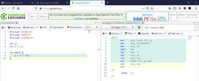

Just curious - are the ASM-optimized math routines supposed to produce exactly the same results as the originals, or are they like the -ffast-math compiler optimization? As in, same mathematical operation, but potentially different results due to floating-point operations being re-ordered, division approximation by reciprocals, etc.
Reply 111 of 731, by dr_st
LightStruk wrote on 2020-11-02, 03:01:
I don't think there are any floating-point operations in DOOM at all, are there?
Reply 112 of 731, by ViTi95
ViTi95 wrote on 2020-10-23, 09:51:
  • As always added more optimizations (mostly ASM optimized multiplications, divisions and modulo, faster screen melting code, faster cheats detection, optimized sound code, faster potato mode [thanks @Optimus6128 !!])
Yes, those ASM optimizations are supposed to produce exact same results, as they are generated with GCC (-O3 -march=<i386, i486>) via GodBolt (for example, https://godbolt.org/z/7e8be7) and then backported to OpenWatcom ASM. OpenWatcom base code is really old, and doesn't have implemented some cool optimizations that GCC has.
The main problem with Vanilla Doom sourcecode is that it isn't possible to use GCC to generate the executable, because the rendering functions (R_DrawColumn, R_DrawSpan, ...) and a big part of the Apogee Sound System are generated with TASM, and GCC doesn't support the OBJ files generated with it.
dr_st wrote on 2020-11-02, 06:23:
You're right, there isn't any floating-point operation in Doom, just fixed-point and arithmetic math.

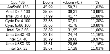

Thank you for the new release, I did some testing with different 486 cpus just to check the performance versus the vanilla doom, here are the results:
9.05 KiB
1120 views
Reply 118 of 731, by ViTi95
Nemo1985 wrote on 2020-12-04, 11:34:
Wow thanks for testing, i'm curious of what hardware specs and configuration did you use for the benchmarks.
https://www.youtube.com/@viti95
Reply 119 of 731, by Nemo1985
ViTi95 wrote on 2020-12-04, 11:59:
I used a Biostar-MB-8433UUD rev 2 with the feipoa modified bios optimizations, 32mb of ram and a pci Virge DX 4mb, the videocard is overkill but on 486 I usually look for such situation to check the raw cpu performance.
