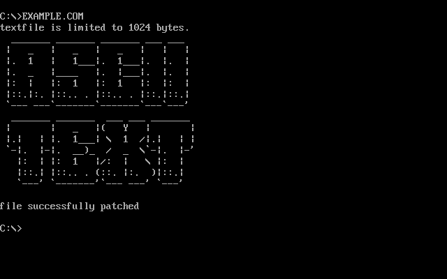

PatchMaker is a DOS program that creates 'patch programs' for files.
Supply PatchMaker with an original and a patched file and it will create a
simple patch program for you.
2.83 KiB
169 views
version 0.14 screenshot
Usage:
The usage is very simple, when you run the progam it will display:
usage: original patched textfile outfile
original: the unmodified original file
patched: is the patched file
textfile: user supplied textfile
outfile: patch program outfile
Example:
> pm original.exe patched.exe mytext.txt mypatch.com

Reply 3 of 5, by Akuma
Jorpho wrote on 2021-01-14, 20:46:
Your efforts are appreciated, but what advantage does this offer over xdelta?
No idea, but PM is small, simple and runs under DOS.
It's nothing like patch or diff assuming xdelta is similar.
EDIT: I did a quick scan on the instructions, I think you can run this on a 8086/8088.
