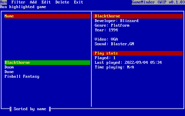

I've given it a test run on my Socket 7 system.
3.46 KiB
960 views

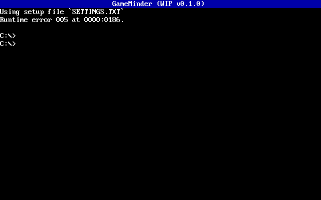

It seems to work as intended, as long as you don't throw anything weird at it. And I do that immediately, so here are the reports.
1. It doesn't like being called by this batch file:
c:\gmind\gamemind
That will throw this error:
1003 Bytes
960 views

3. It only seems to like C:\ drive. I have a game library on E:\ and set this to my scan path. It scanned fine, but launching any games returned this:
1.25 KiB
960 views
I wondered if using the root path was an issue, so I moved a few games to E:\Games\. But this had no effect. It wasn't until I moved my tests to C:\Test\ that I got games launching.

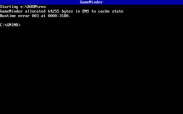

4. Can not currently set a batch file as exec in !GM_INFO.txt (it likes EXEs only) which is a hindrance for many games. Generally they'll fail to run with a message similar to above. In the case of Dune, calling dune.bat forces a reboot 😮
Showing promise though, and looking forward to updates.

GameMinder assumes that the directory it launches from is where the program is. I can't think of a way round this, but I can certainly make it detect if this has occurred and show a useful error message on startup.

Nice thought. Yes, I hadn't given any consideration to other drives. I'll have a think about this.

Oh dear, that's not good! 😁 I'll research into this one.
