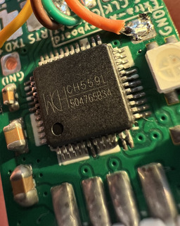

Tried attaching the mouse logitech b110s and the HIDman with the new build and it sadly stopped to responding after outputting: […]

do you have a model off mouse that work? so i could try buy one and just to be sure everything is working as it should 😉 even tried wireless logitech with unifyin reciver , dell wireless mouse, logitech g305 and gives me same act sadly
OK that's just bizarre, I am not sure what's wrong there at all. Maybe a different silicon revision of the CH559?
I have just ordered a new batch of hidman PCBs, if you send me one that doesn't work for investigation I'll send you one of the new ones. I've DM'd you my address.
Luckily i have a iphone that is able to take a picture of the chip, as i cant even see it with my eyes 😉

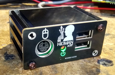

If I'm planning to build one of these, should I build the PS2USB or AXP version? I know they are still a work in progress but I'd like to contribute with testing, etc.

sofakng wrote on 2023-05-10, 15:26:
It looks like the AXP version is the 'better' version with the extra serial output feature?
Yeah I would recommend building the AXP version, it's actually cheaper despite the extra port (enclosure is less than half the price).

Reply 177 of 201, by rasteri
sofakng wrote on 2023-05-10, 15:57:
By the way, was there any change in the AXP PCB from the original version? It looks like I ordered some a while ago and didn't even remember, haha. However, I forgot to order the enclosure front/rear panels so I guess I might as well order the newer AXP PCB too...
Yeah I moved the position of the reprogram switch and LEDs. So the front panel will no longer line up with the old PCB.
Current rev is built and seems to be working, just need to test fully.
Reply 179 of 201, by rasteri
sofakng wrote on 2023-05-11, 00:51:
Thanks for the update. I'll plan to order some PCBs unless I hear otherwise.
Just tested it, it seems to work.
I suppose the AXP version in github should be considered more or less"version 1.0", as I can't see me changing it much after this.
of course the firmware still needs a bit of work but it's very usable.
