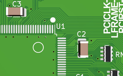

Tried this on my Prime B450M-A again, this time connected dISAppointment's PWRDN# to one of the motherboard TPM header's +3V with a 10k resistor in between. Still no avail. Most likely my unit isn't working. At least this board always boots unlike my Intel ones which would not boot as long as it's connected (whether dISAppointment itself is powered or not does not matter).
I wonder if the BIOS option of whether to use firmware TPM or discrete TPM played a role here... as the TPM header is connected to a separate LPCCLK. Will consider making my setup program look at a few more registers to see what's really going on.
On the other hand... I'm not certain about the F85226FG/F85226AF's orientation (it's on the other side of the PCB which was never shown), though I don't think I got that wrong according to the information in the PCB file as well as in the datasheet.

Reply 171 of 511, by rasteri
LSS10999 wrote on 2023-06-17, 06:17:
Yeah kicad's default pin marker isn't very clear, but there's a white line alongside pin 1. Next rev will make it more clear

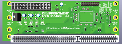

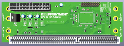

I've almost finished the second revision. New features :
  • Smaller - should now fit in alongside Micro ATX/Mini ITX motherboards
  • Moved holes to match case standoffs when installed as above
  • Voltage indicator LEDs
  • -5v power supply (Voltage Blaster-style)
I know people have requested I replace the ATX power connector with molex or SATA, but negative voltages are typically used for analog signals and I doubt my ability to design a quiet enough negative voltage converter circuit.

Reply 173 of 511, by LSS10999
rasteri wrote on 2023-06-17, 17:38:
I've almost finished the second revision. New features : […]
Excellent, looking forward to it. Just a question: Is the PSON signal still exposed somewhere like in previous revision?
At present I'm using a DC12V-to-ATX24 adapter to power dISAppointment and the PSON signal needs to be shorted (with a jumper cap) to allow the adapter to supply power.
Maybe I really should be using an actual ATX splitter, though good quality ones tend to be thicker...
Reply 174 of 511, by rasteri
LSS10999 wrote on 2023-06-18, 03:32:
Oh, no - I didn't think anyone would need it. I'll put it back in.

Reply 177 of 511, by rasteri
Been away on holiday but I finished up the design and have ordered it from PCBway. Assuming it works that'll be the first official release.
I also bought an AMD AM4 motherboard, hopefully we can get that working too!
