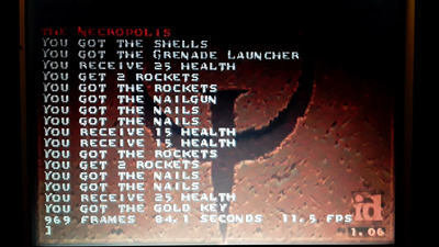

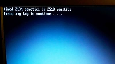

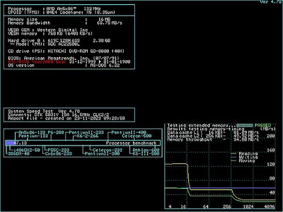

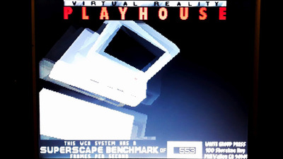

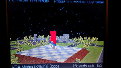

Just wanted to make a small contribution to this most excellent thread. I have a DTK PKM-3331Y that I picked up quite some time ago in rough shape as I recall. I had to remove dead Dallas RTC and replace with a socket and an aftermarket Dallas replacement that uses a CR1220 battery, had to track down a keyboard controller chip, BIOS EEPROM, and oscillator as originals were gone, and had to do a complete cleaning job using IPA and distilled water and a make-up brush as board was extremely dirty. The end result is a running board for an all ISA 486 build that performs far beyond my expectations. The rest of the system is based on an Evergreen AMD 5x86 upgrade CPU running at 133MHz, a DFI WD90C31 1MB ISA video card, a Winbond ISA controller card, and an ESS 1869 ISA sound card.
I have an EEPROM programmer and I tried every Symphony Haydn II BIOS I could find on theretroweb.com as the original DTK BIOS for this board has almost no adjustments at all, and most of the other ones I tried had various problems. Thanks to the kindness of member 'Anonymous Coward' I was able to obtain the best BIOS for this board that allows a reasonable level of tweaking and I began my search to see what this combo could do. Remarkably after switching from a Seagate 1GB hard drive to a WD 2.5GB hard drive, this board will run completely stable at an ISA speed of CLK2/2 which should be 16.5MHz. At these ISA speeds the performance of this board with the 5x86 133MHz is pretty impressive. Using Phil's DOS benchmark pack, here are some results:
Quake 1 timedemo: 11.5FPS, Doom timedemo (high quality): 29.76FPS, Chris3D benchmark: 39.8FPS, 3DBench 1.0C: 55.3FPS, PC Player benchmark: 15.9
I am tempted to find a 40MHz oscillator and see if either of my two Evergreen 5x86 upgrade CPUs will do 160MHz and push this combo a bit further, but at the moment I'm quite happy with it's existing performance. Build engine games such as Duke3D or Blood run well at 320x240, as do Doom2 mods such as Strain so when I'm done with some gaming I'll investigate further. Thanks to all the contributors on this thread, I actually looked for one of these boards based on discussions I saw in this thread originally!
