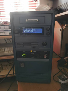

I was last of the early birds to get McCake. It arrived yesterday. Fully MT-32 compatible MIDI daughter board is quite unbelievable. And it supports soundfonts as well. I didn't have time to test it yet but I'll try to do so today. It should be an excellent board for any MS-DOS gaming system, Copam included. I don't really need it for Copam since I have the external MT-32 for it. McCake likely goes to my Super Socket 7 system. It has 550 MHz K6-2+ and Voodoo 3 so it can run early Windows 98 games nicely, even though it is meant to handle end of MS-DOS era (everything that my 100 MHz DX4 system cannot do). I have Yamaha DB50XG on the SS7 machine at the moment. The Yamaha is there in case I want to play Final Fantasy 7 with XG MIDI support. But there are XG soundfonts that McCake can use so maybe the McCake could be of best use in the SS7 system. I'll just have to try.
But what if I wanted to put the McCake in Copam? There are some problems. First I would not want to try fit it between Orpheus and GUS Classic. And GUS Classic does not fit to the other ISA slot without extra trouble. And if Orpheus was on top and McCake on top of that, then there would be the problem that I wouldn't be able to see if weight of the monitor somehow presses McCake. But I could use a cable and relocate the McCake elsewhere. Only place would be where 3,5" hard drive used to be and I wouldn't even need a long cable for that.
Next there is the heat issue. After all McCake is a computer of its own and ventilation is already quite minimal. Perhaps best solution would be to make a hole under the 3,5" hard drive tray and put a fan there. It would directly cool the McCake, and also the CPU would be near too. And I wouldn't have to do any visible holes anywhere. Better ventilation would be a good thing even without McCake. The problem would be how to actually make a large hole. This computer is heavier than it looks so making a large hole would require good equipment.
After all that there would still be a problem left. PSU is only 65 watts and I don't know how much is for 5V and how much for 12V. It is likely that McCake would be too much and I'd have to replace PSU. So McCake would require too much modifications for this machine.

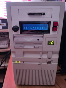

So the computer is ready for now. I changed the picture on the first post but here is a link to it. I moved the computer to where my 286 used to be. Notice the MT-32 (old type 1.07) on top and a new monitor! I found a very nice 15" Belinea 10 50 35 for only 5 euros. It is very hard to find 15" and smaller CRT monitors here in Finland. If you find a CRT monitor, it is likely one of the cheap 17" models. In my opinion 17" is the worst possible monitor size for DOS gaming. It has scanlines that were not supposed to be visible on VGA because of scanline doubling (but CGA and EGA monitors should have very visible scanlines so I suppose those modes are displayed wrong on a small VGA CRT). If scanlines do not matter, then 19" is better size (if you can find a good one without geometry issues). If you don't want scanlines, then 15" is the maximum size. So nothing good in 17", unless you really want scanlines and 19" is just too large for your table (and they can be).
