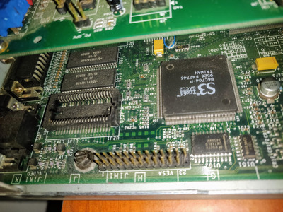

Reply 26 of 27, by soupapes
I noticed that I have two slots available for what I believe to allow add more memory to the S3 onboard GPU wich currently has 1Mb.
I suppose it can receive two 512kB chips right?
Anyone knows the correct reference of those chips and where can I find them for sale?

Reply 27 of 27, by b0by007
I have an IBM PC 330 6577 and I maxed out the onboard video ram with these parts from chinese market:
https://www.aliexpress.com/item/1005002119453898.html
https://www.aliexpress.com/item/1005004097700159.html
These chips worked on other standalone videocards I have: Cirrus Logic, Alicat, S3 trio...
They dont improve speed, just increase the maximum resolution we can use in windows 95.
