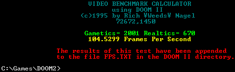

Does DOOM (or any of the the other older DOS WAD based games that run in 320x200 8-bit) actually benefit from some of the more modern video cards (especially when ran on higher-end machines)?
Just a-wondering; as I've always thought that even with a cheaper video card, on an extremely fast CPU the difference would be nominal.
BTW, if you (or anyone else) has DOOM II v1.9, attached is a handy little utility that I threw together eons ago. It completely automates the framrate testing, and sets up DOOM II the same way each time the benchmark is run 😀
