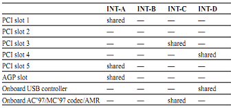

If you disable USB and onboard audio (if you have that), you can get 3 PCI slots with no IRQ sharing.
