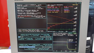

Reply 141 of 325, by skv400
CPU : Cyrix 486DRx2 66MHz (33x2)
M/B : Dataexpert OPTI-495SLC Rev 1.01
RAM : FPM 64MB 30pin 16Mx4
HDD : Fujitsu MPB3032ATU 3.2GB E-IDE
FDD : 5.25 x1 , 3.5 x1
SND : Creative Sound Blaster 32PnP w/CQM
VGA : Cirruslogic CL-GD5428XL 2MB VLB
I/O : IWill SIDE Jr. Pro E-IDE VLB

Reply 142 of 325, by feipoa
skv400, do you have a Cyrix FPU installed? If not, could you install one? The Speedsys results tend to be artificially high if you do not have an FPU installed.
Reply 143 of 325, by Anonymous Coward
The hardware in this system is pretty nice, though the inflation on your CPU speed score is pretty crazy. Also, you might want to check your BIOS to ensure your memory timings are tuned. I know OPTi 495 doesn't get very high scores for memory bandwidth, but yours is a little too low in my opinion.
Also, if possible please run doom -timedemo demo3 and tell us how many realtics you get.
Reply 144 of 325, by elianda
There is even more wrong, if you look at the memory performance graph there is no indication of the 1kB L1 Cache.

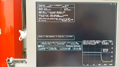

Reply 146 of 325, by skv400
according your opinion. i go to setup and turn on auto configuration and manual setting memory timing to get more memory peformance.
sadly. i don't have cyrix fastmath 387 fpu. only have iit 4c87dlc and ulsi 3c87, intel 387dx
this benchmark result is only cyrix 486drx2 66mhz put in. no co-processor.
i recorded this bechmark. can see https://www.youtube.com/watch?v=03vOB2RLDtQ
turn on -> setup -> nssi -> speedsys -> doom timedemo3
Youtube Channel : https://www.youtube.com/channel/UCeaVPa3VMe9nUGDtFtVzvDQ

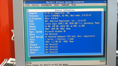

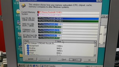

Reply 149 of 325, by skv400
So great. My motherboard's memory peformance is too poor.
26mb/s is impossible.

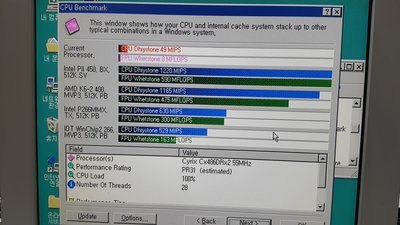

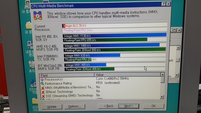

I upload my sandra99 result.
I put in iit 4c87dlc-40 on 33mhz because windows98 won't boot without coprocessor.
If i get cyrix 387. I will upload newer speedsys tesult.
When i go to home, i will run ctcm1.6r3 and cct386 and upload result.
I go to seoul toady because my teeth is broken.

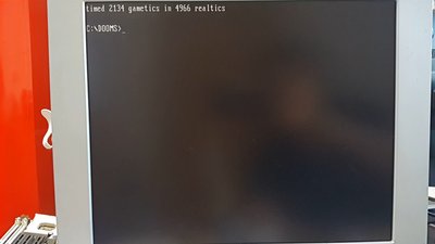

Reply 150 of 325, by Anonymous Coward
What's wrong with using one of your other FPUs for the speedsys benchmark? Any of them should be okay.
Also, can you please rerun doom timedemo with the screen maximized? You can toggle this in game with the +/- keys. It's not really possible to compare your DOOM score to other systems unless they are all rendering the screen at the same size.
Reply 151 of 325, by skv400
okay. completed fullscreen timedemo3 and upload movie.
and i live in south korea.
i go to speedsys benchmark w/ulsi and iit coprocessor
except 387dx because broken pin and don't boot.
youtuve link : https://www.youtube.com/watch?v=Wsj4ATeA7F0

Reply 152 of 325, by Anonymous Coward
Your doom timedemo result is very interesting.
I also have a 386 with an OPTi495 chipset, however mine is the 495SX not the 495SLC. The only real difference is that the 495SX has buffered VLB slots...they are more compatible, but they run slower. My board does not have VLB slots though.

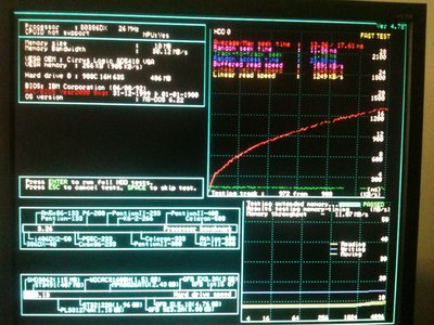

Reply 153 of 325, by BSA Starfire
Here's my IBM PS/1 2133/2155 386sx 25MHz motherboard with ULSI 387sx FPU.
Vogon's thread about the board here:My new IBM 386 build
Speedsys screen, notice it thinks it's a DX chip??? Sorry the pic is not great, old phone is all I have. CPU score is 3.26.
Doom realtiks, full screen are: 33620
1.53 MiB
1789 views
