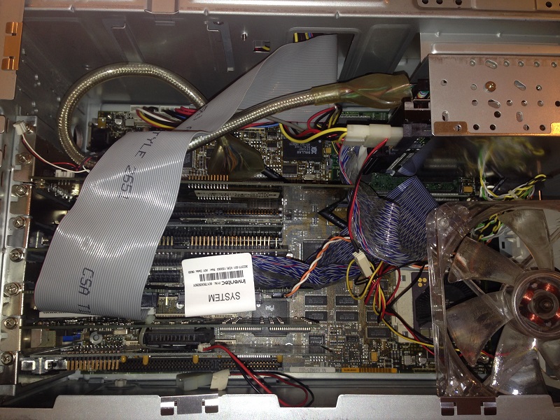

Intel Premiere/PCI motherboard with 32MB of RAM and the PODP5V133 installed. I'm missing the fan on the CPU, so have to use external cooling. Luckily it is based on the newer Pentiums so it does not run very hot compared to the original P66 5V CPU.
Closeup.

Everything installed
The COM ports on the board is not working (someone has changed the keyboard DIN port at somepoint and ruined the ports with the sloppy soldering). So to be able to use a serial mouse I've installed an ISA IDE I/O card.

The system have been very stable and performance wise it is about equal as a quick Pentium 100 in a Socket 7 system with Pipeline Burst Cache. If someone is curious to see how it performs with both an original Pentium 66 CPU and the Overdrive currently installed take a look atPhil's VGA Benchmark database. It's missing a PS/2 port which is the biggest drawback atm.
