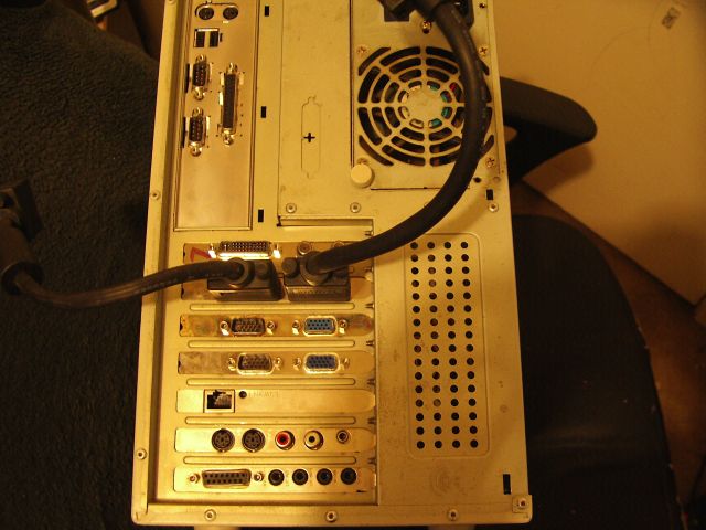

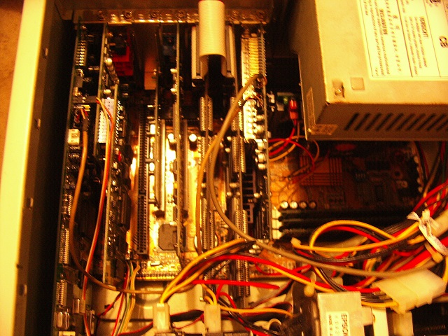

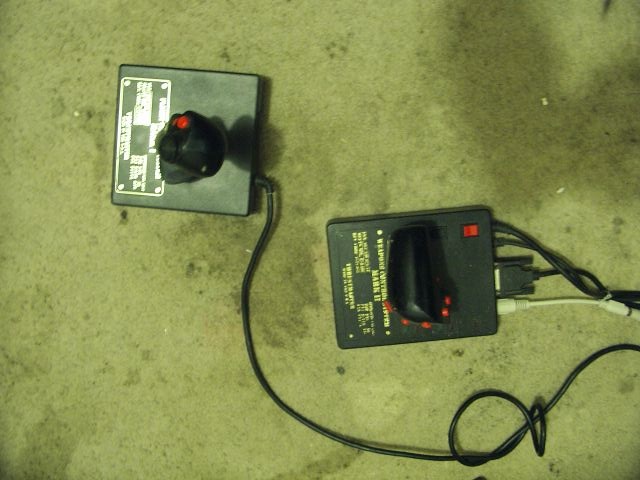

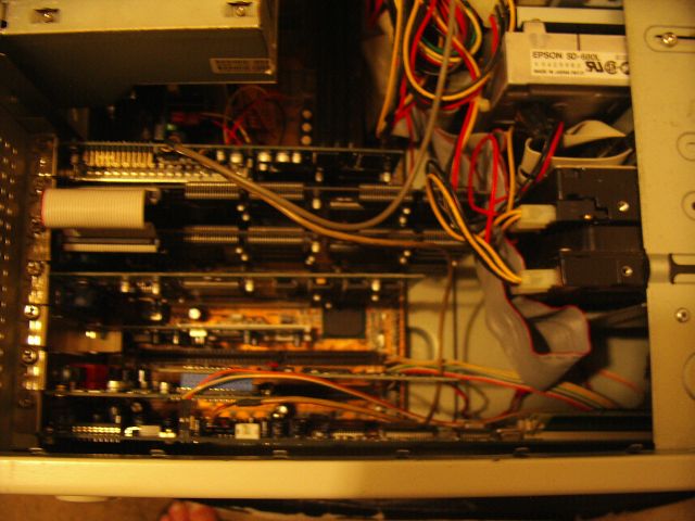

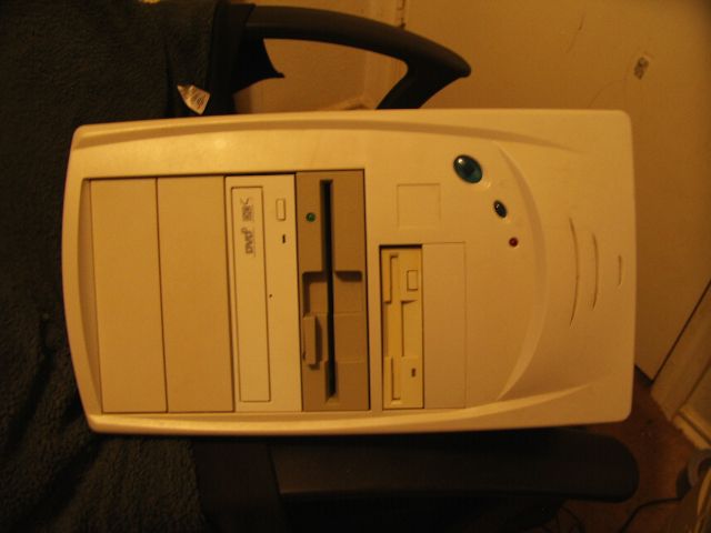

As promised, first array of pics 😀 The switch box hasn't arrived yet and neither has the CM-32L. So, for switching from V2 to V1, I have to manually move the pass-through cable & monitor cable from the V1 to V2 or Vice Versa. When the switch box arrives, I'll put up pictures of it in action. According to others, it should work just fine. I'll also add pictures when the CM-32L arrives as well 😀
    167.4 KiB
    1887 views
    Cards Vertical
    38.81 KiB
    1887 views
    Mixer + MT32 & Audio Switch

    Back
    33.15 KiB
    1887 views
    Front

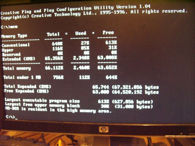

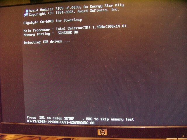

Reply 12 of 18, by FeedingDragon
Pics Continued:
    69.17 KiB
    1883 views
    Configured memory

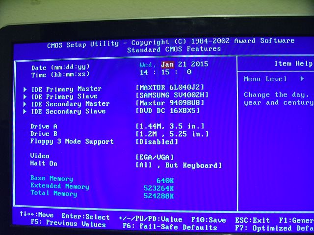

    77.35 KiB
    1883 views
    BIOS Screen

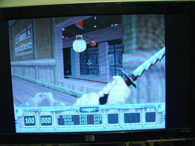

Shadow Warrior 3dfx

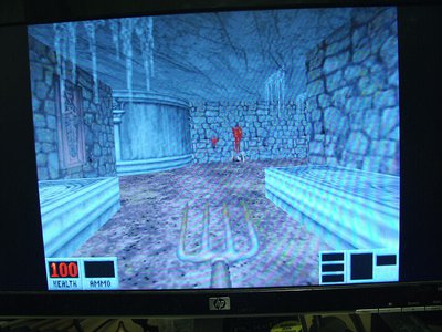

Blood 3dfx

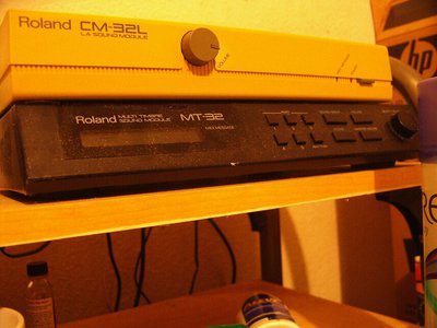

Last piece arrived 😀

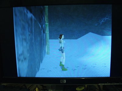

Well, found out how to get a V1 & V2 to work together in the same system. What I ended up doing....
1) Place the V1 before the V2's in the PCI slots: Not sure if this is actually necessary, but the post I read suggested it might be, so that's what I did.
2) The Pass-Through cable goes to the V1 and not the V2's
For some reason this is what made it start working. One issue I discovered during testing. If Tomb Raider is loaded through the Voodoo Rush EXE file, even with a V1 GLIDE2X.OVL file, it won't work through the V1. If I use the V2 OVL file, it will work just fine. Only, the static linked EXE file will stop working after that until the system is powered completely down and then restarted. If I use the exact same V2 OVL file in another game (such as Shadow Warrior,) the static linked EXE file continues to work fine through the V1. With the V1 in the system, even setting the environment variables won't let it work through the V2 for some reason. Not sure what the issue there is. (EDIT didn't finish that thought for some reason)
As promised, the Pictures of V1+V2+V3 working together 😀
Tomb Raider through the Voodoo 1 card:

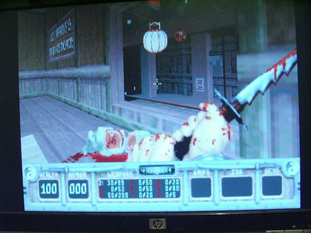

Shadow Warrior through the Voodoo 2 SLI cards:
154.77 KiB
1446 views
Voodoo 2
Blood through the Voodoo 3 AGP card:
192.74 KiB
1446 views
Voodoo 3

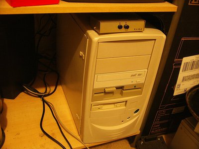

Reply 18 of 18, by FeedingDragon
Final pic, I think, unless something else changes or someone asks for something specific. 😀
System closed up and in place.

173.07 KiB
1393 views
System closed up & in place.
