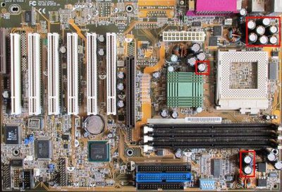

Reply 7 of 47, by mockingbird
The following capacitors need replacing:
The attachment IMeSv2qh.png.jpg is no longer available
(Decommissioned:)
