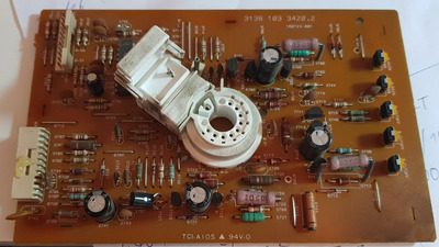

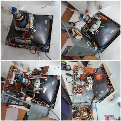

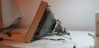

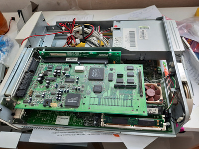

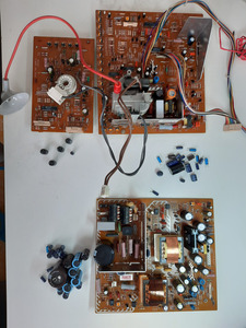

Hi all,
So to keep the thread on these awesome machines alive:
As I have two 460s, I decided to put together one from the best parts taken from both, and leave the second for backup (for now at least).
The trouble is, the one with the good screen had some damage on the front bezel around CRT (melted hole right in view) which is very irritating.
So I decided to swap the bezels. This of course means a complete disassembly of the thing. While doing that, I decided to thoroughly clean every part and do some preventative maintenance/recapping.
If this is of any value, here are some pictures I took during disassembly, and list of electrolytic caps for replacement (the specs of caps are marked as uF/V):
1) Mainboard (1pc total)
100/25 - 1pc
2) Power supply board (18pcs total)
150/25 - 1pc
1/50 - 1pc
470/25 - 1pc
100/63 - 1pc
100/25 - 2pc
10/25 - 1pc
1000/16 - 2pcs
470/16 - 1pc
220/100 - 1pc
1000/35 - 2pcs
2200/35 - 2pcs
4700/16 - 2pcs
2200/16 - 1pc
330/400 - 1pc
3)CRT neck board (5pcs total)
10/160 - 4pcs
100/16 - 1pc
4)CRT driver board (20pcs total)
10/16 - 2pcs
47/160 - 1pc
47/25 - 1pc
1/50 - 4pcs
47/16 - 1pc
1000/16 - 1pc
4,7/160 - 2pcs
100/16 - 3pcs
470/16 - 2pcs
47/100 - 1pc
4,7/25 - 1pc
6,8/50 - 1pc (looks non-standard, custom made)
This was my first time disassembling a monitor, handling CRT and respective analog boards. I took necessary precations, not too bad overall.
Diassembling both, I noticed minor differences btw the CRTs themselves and few components, but functionally looks the same.
I will try and make more pictures as I reassemble the thing after recapping and cleaning.

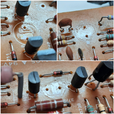

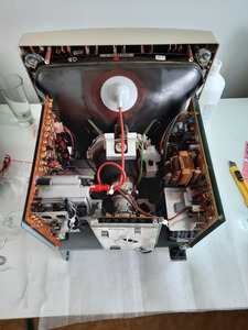

Reply 82 of 88, by assasincz

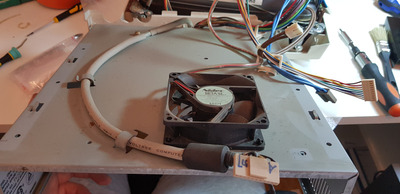

Recapping finished. I also hot glued a few things down and did some cable management. I am glad I did it, since there were indeed some leaking capacitors, as shown in the picture. I replaced all except one on CRT driver board that I could not find a replacement of proper size.
I removed the 80mm fan that moves air from system board compartment to the monitor compartment, and put in its place a Noctua fan, and wanted to power it from the system board. The trouble is that the power supply board freaks out when there is no fan plugged to its fan header, and does not power on properly. Running the Noctua from the header was not working. So I shorted the fan header pins and now it works nicely.
I also stuck a 40mm Noctua fan to the Overdrive heatsink. You may notice CT3670 and SD-IDE in the system. Also now there is 16MB of RAM.
I am properly satisfied, having the 460 next to me running completely silently, playing Doom demo as I write this post...
