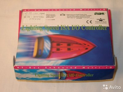

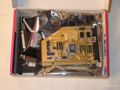

Got the controller — it's a Iwill Side-2610.
133.59 KiB
1748 views
65.96 KiB
1748 views
An I/O controller is probably not the sexiest thing in the world, but still, the condition of this thing (released around 1994) is impressive. I think the previous owner only took it out to make the photos for a listing.
I can also confirm it works beautifully. I used the installer on CD version of the Dune game (the first one) to benchmark the transfer speeds. It used to be 140-150 KB/s — now it's around 850 KB/s. Also tried Full Throttle — no significant stuttering, so I guess the CPU is not too stressed by this controller.
Also got an OPL-3 enabled CT2770 in this machine. I guess, I can say it's complete now.
Thanks everyone for all your help! It's been a long road — took me 2,5 months to finish this system but I feel like it's worth it. Guess, my next step would be getting a DOS-friendly GM device.
