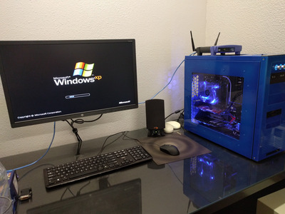

Hey Vogoners, I am writing from my P4 system right now. Have some updated images. Case is still at the powdercoater this week. Hope to get it back soon.
Here we go!

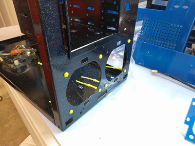

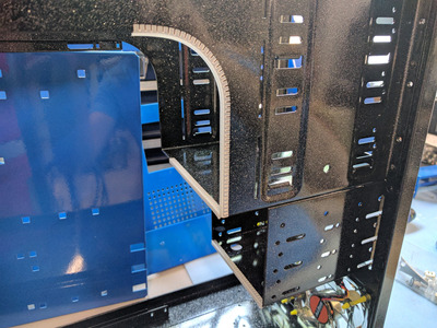

On to the case, my old Lian Li PC-65B
It had the old backplane that I had hacked on and fiddled with several times over several iterations of case 'eras', and I decided to draw up a new one and waterjet it. I removed the rivets and brackets from the original Lian Li backplane and scanned it on the office scanner. I measured a few dimensions on the physical piece and scaled the scanned image in solidworks. This allowed me to create a 2D file to use for waterjet.
On the right is the new piece.
And installed in the old chassis:
More to come!

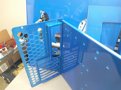

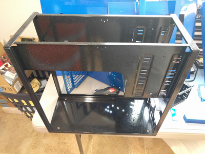

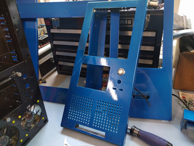

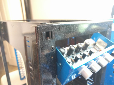

Sorry for the long delay! I am alive and well and have two daughters and moved to a new home! Anyway, my little XP rig is doing great, I got the components back from the powder coat shop, the frame was done in black with silver metallic clear and the externals are candy blue with metallic clear. I added some UV LED 80mm fans for the front intakes and got everything installed and booted up with XP SP3. I'll do another update with software stats soon but just running a basic XP install at the moment.

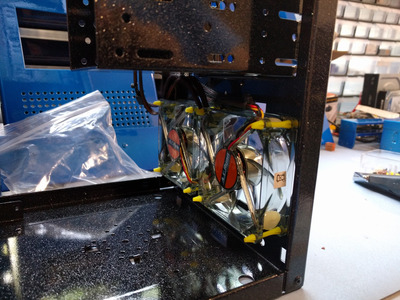

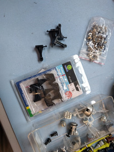

I also installed some new old stock lian li replacement clips and such while rebuilding the case.

Your build looks fantastic! The paint work is top notch. I like the almost-period-correct Linksys access point 😉
Thanks, Yeah I don't know how many times I've thought to check in! Hope to be around more
Love this community though. 😊 Quite the interesting hobby.
Yes those darn linksys WRT routers are just indestructible, I have had that thing for 20 years probably. Finally decomissioned it in favor of newer ubiquiti APs but it was still working just fine out in my workshop there running DD-WRT or something if I recall!
